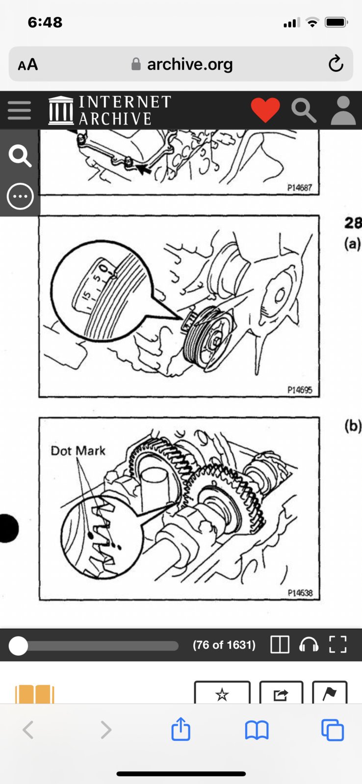

    Did you take the gears off the cams?

  11. Mar 12, 2024 at 4:50 PM
    ControlCar
    ControlCar My Moto: Help & Learn…period.
    Jul 22, 2023
    #429578
    3,066
    Steven
    Sugar Land TX
    1996 Taco 2.4L 2wd Automatic
    Clock Volt meter/LSPV Delete/Hyundai 16’s/FP gauge/after 9months of wrenching ZERO oil leaks
    The lower pix shows the cam shaft gear markings I was talking about
    Looking towards radiator

    I don’t think your screwed
    just as long as you set TDC to bottom end/block(should be easy with head removed)
    Then assemble per that manual with those dot marks on inside of cam gears
