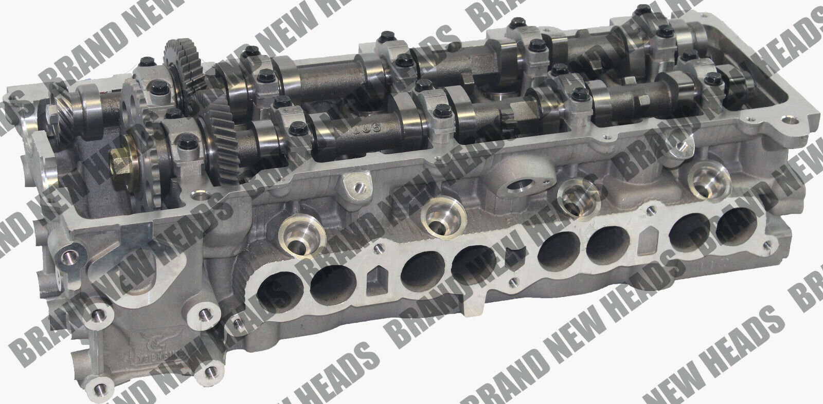

    Myself I bought a reman 2rz block with a two yr warranty for $800 from out of california.....and a new design new head out of texas for $699....with a 3yr wty...
    but all the bits to put it together double the price.....not including the $1400 labor to put it together and install it......and well 3 cases of corona gold....
    BRAND NEW Toyota 4Runner Tacoma T-100 2.4L 2.7L 2RZ 3RZ Cylinder Head 1995-1999 | eBay

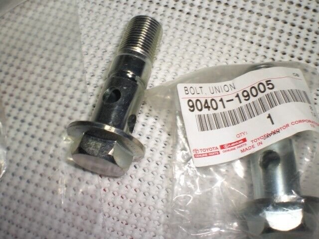

    I forgot the oil canister bracket is different on the two engines...
    I was sweatin to find one to fit the new 2rz.......3 yrs back I found the only one in America...
    for $60 out of a salvage in Huston....
    and then nobody in the US had that U bolt to attach it to the block...
    that had to be ems from Japan.....bolt was $14......and ems was $34...
    90401-19005 Bolt, Union(For Oil Filter Bracket) Toyota
    and then the washer/oring kit to attach all that was another $25 w/ship from yota1...
    Basically another 2 month delay to get everything to get it back together on the road.......
    Ohh , and another case of corona, and another $100 tip to the mech to dick with all that extra...
    What a PIA....

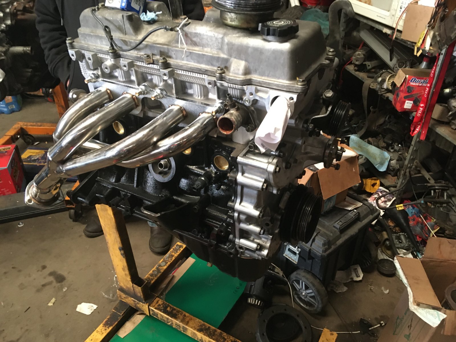

    I've got baby pictures....

    Damn OS ….. u ballin out with those headers
    LC eng.??
  6. Dec 2, 2023 at 8:56 PM
    O'Silver_Taco
    O'Silver_Taco Well-Known Member
    Aug 26, 2021
    #375390
    4,182
    MD
    98 Dlx Sr5 ext AT Rwd
    3rz to 2Rz bebuilt block and new heads
    Nope.....$100 ebay ones...
    And I figured I might as well get the JC whitney matching cat.....
    and the direct tacoma replacement walker mid pipe, and walker muff and tail pipe from advance......20% off coupon...
    for the icing on the cake.......
    some things ....you dont want to go back.......
    that mechanic only charged me a $100 to weld all that in extra..
    when they were putting the engine in....
    hell of a deal...
    they cut the flanges and straight welded everything.....
    so none of that donut leak shit between the pipe flanges will ever plague me.....
    and they tack welded that slip pipe that goes into the muffler......so all that cat water doesnt build up in the muffler...
    these guys really knew their stuff..
    took em less than an hour...
    I ended giving them an extra $100 tip when all that made its first 1K...shocked their shit...
    I even gave em extension/ swivel magnetic spark plug socket for making it past that xmas...
