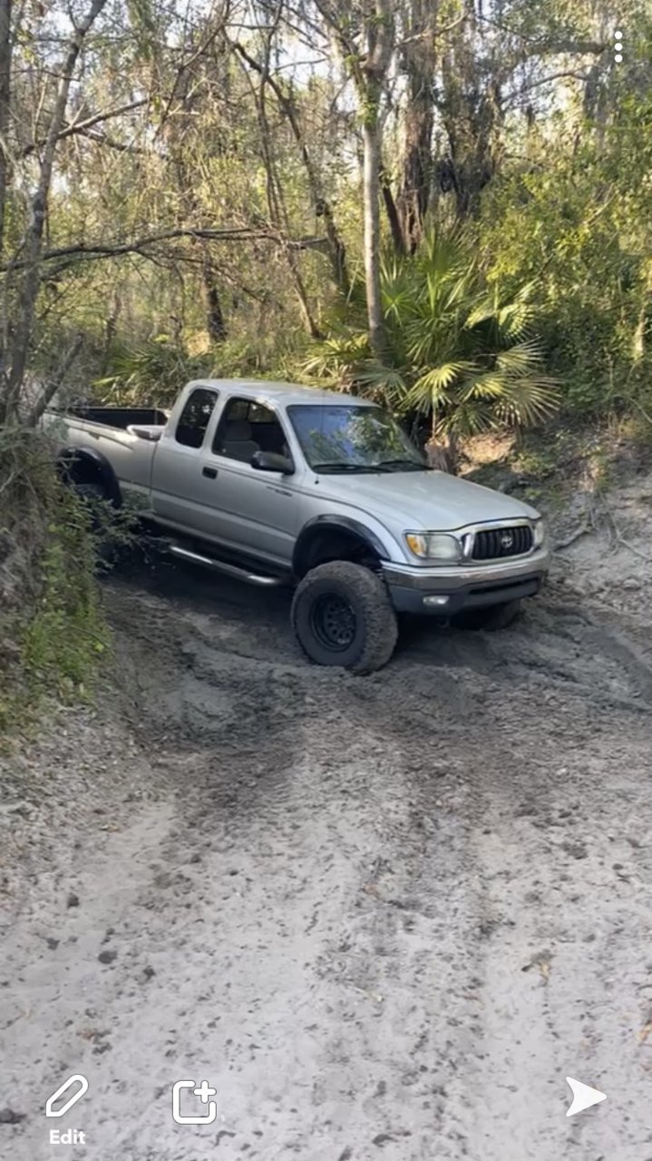

    ‘04 Tacoma 3rz 4x4 manual. Has 2” body lift with fox shocks that give it an extra 2” lift as well. 4.30 gears with 33x12.50x15 tires.
    I want to get more power under the hood as the truck struggles up hill and pulling a trailer is certainly a struggle. I’m thinking of swapping the engine for a 5vz. I know the motor mounts are different but anyone else know what other issues I’ll run into? Can the w59 handle the v6? I’m not thinking of adding a supercharger and I figure the 4.30 gears will help out too.
