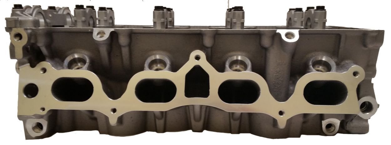

    Why not?

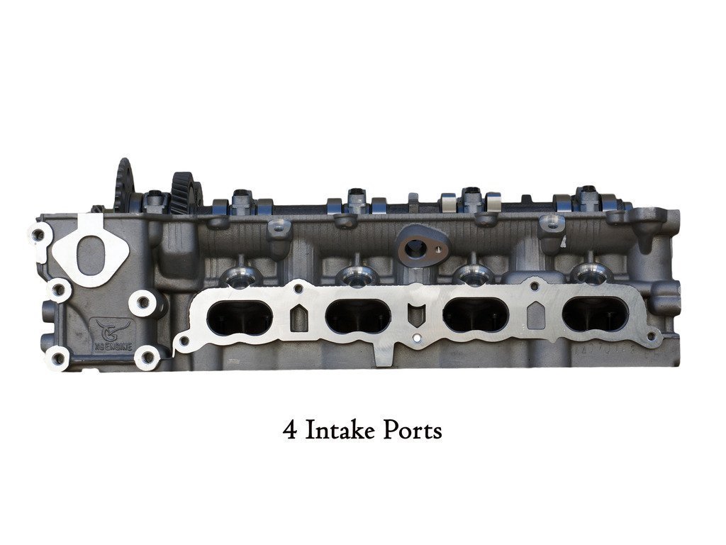

    Intake manifold gaskets and bolt patterns look the same on both engines. The block is also identical between the two. Power steering pump is in the same location too so serpentine belt routing should be no problem.

    Different head, bolt patterns are different.

    Which bolt patterns? The ones from manifold to head are the same

    Intake

    No they are the same

  7. Oct 30, 2017 at 8:57 PM
    05Taco4x4
    05Taco4x4 ToyotaHubs
    Jun 29, 2011
    #59085
    6,257
    2TR-FE Enthusiast
    FJ Tcase, Manual Hubs, 2017 Head unit, Mirror Riser
    3RZ
    2TR

    I think it's probable that the spacing is very close between the two, so it would be very possible to make it work by replacing the flange. I considered this a few months ago.

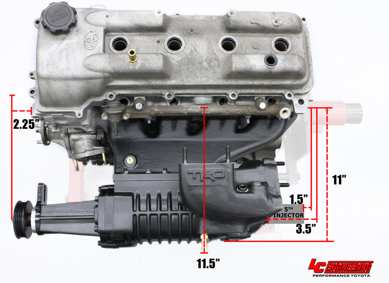

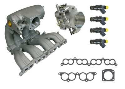

    But if I were doing any fabrication work, I'd just make an intake and install a M62 from a Cobalt or M90 from a 3800 (same SC on the 3RZ TRD Kit).
    LCE was kind enough to provide us with measurements
    Kuntrykid and TireFire[OP] like this.

    Ahh, it is flipped upside down pretty much. Thanks
    Edit: not just flipped I guess the patterns are slightly different too. Damnit

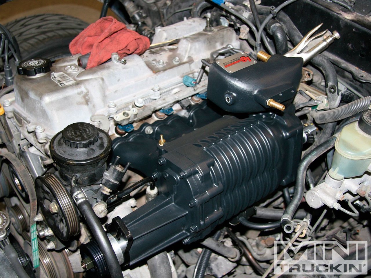

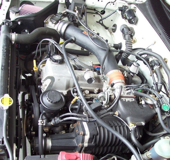

    Yes I've seen these measurements that's how I came up with the idea of bolting this guy onto the 2trfe because it "fits" except for the flange I guess... the unit in the pics is an Eaton M62 by the way which is a better fit for the 2.7 because it requires less HP to be driven. They use the M90 charger on the larger 4.0 which can handle more parasitic loss

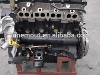

    Chinese 2trfe from Hilux Vigo:
    This version seems to use an 8 port head which should flow a little better than a 4 port head. This bolt pattern seems to be exactly the same this time as the 1995-1999 8 port heads on the 2/3RZ so the TRD supercharger should bolt onto it:

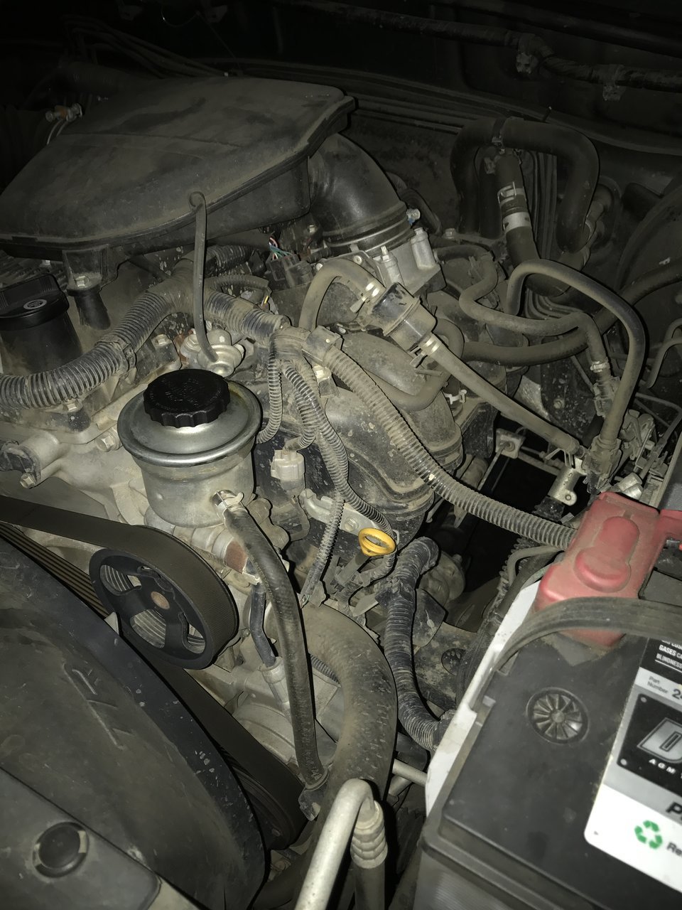

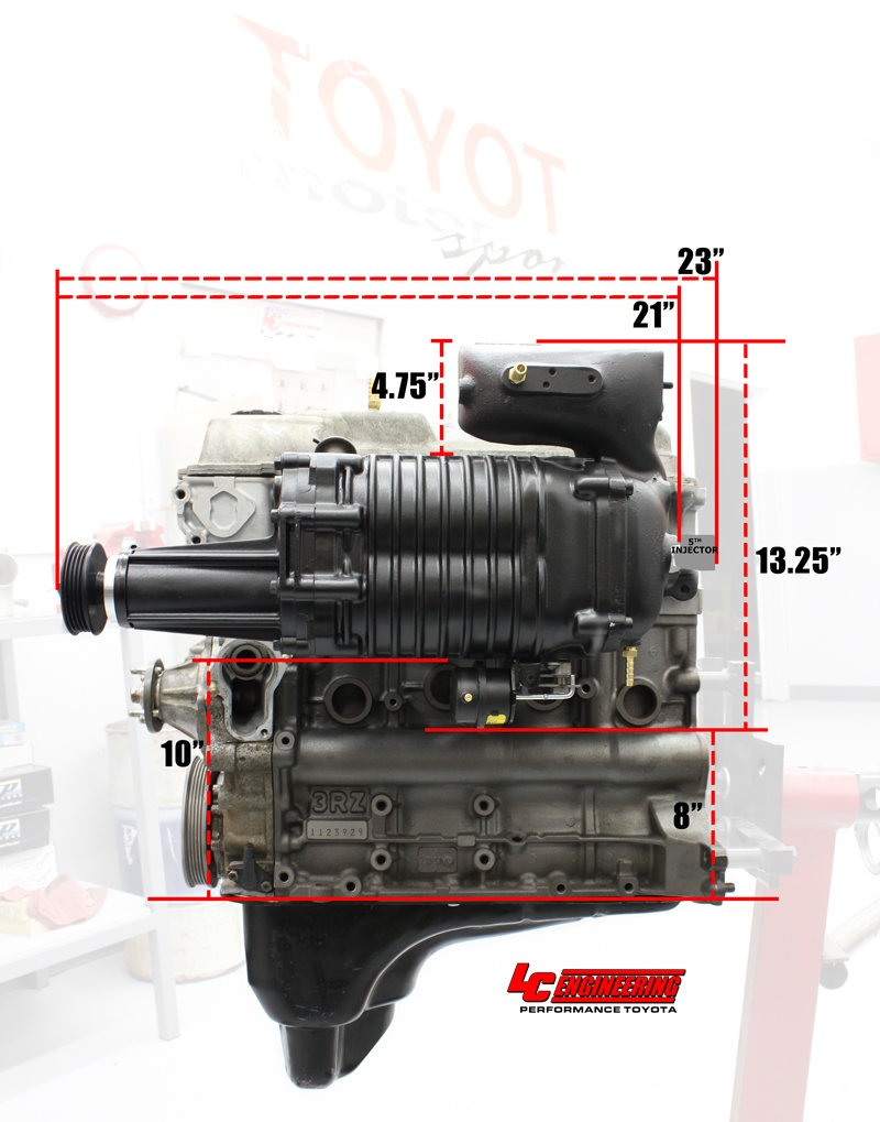

    This said, I don't know if you could bolt the Chinese 8 port head on without any other modifications. Here are some pics to illustrate my thoughts. My engine bay:
    3RZ with TRD charger:
    As you can see the space is there, easily.
    Reportedly, the timing cover on the 2trfe is a little thicker so the supercharger pulley would not immediately line up with the serpentine belt but it's not far off, ~1" so a pulley spacer should do the trick - if it's even needed.
    So far in my research these are the only obstacles to using this kit on the 2trfe
