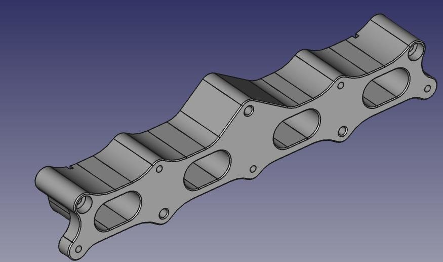

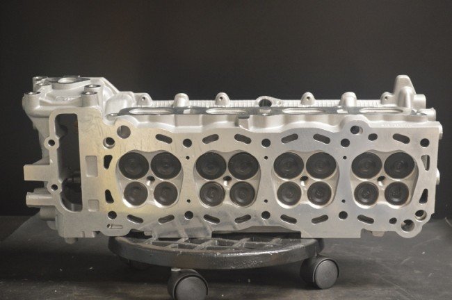

    Head bolts are same location on each head. Intake bolts are centered over those, we're good

    You draft really well. It looks great! The sensor appears to protrudes from the head 1-3/4" and if the adapter is 2-3/8" thick overall then the 3RZ side must be 5/8". That should work well. Does it have a "dog leg" on both sides?
    05Taco4x4[QUOTED] likes this.
  7. Apr 8, 2018 at 6:13 PM
    #67
    05Taco4x4
    05Taco4x4 ToyotaHubs
    Jun 29, 2011
    #59085
    6,257
    2TR-FE Enthusiast
    FJ Tcase, Manual Hubs, 2017 Head unit, Mirror Riser
    Yes, it's on both side.
    Question: do the bolts that attach to the head have to be counter-sunk? I know you were talking about it earlier, but didn't know if it applied to this design.

    After looking at this pic, the bottom is good.

    Could you make it only have a "dog leg" on the side with the sensor only for strength?
    Then bring the 3RZ's two upper bolts to have the same lobe on the 2TR side of the spacer?
    Finally, counter sink enough on the 2TR's side to allow for an Allen bolt's head to sit at least flush with the surface?

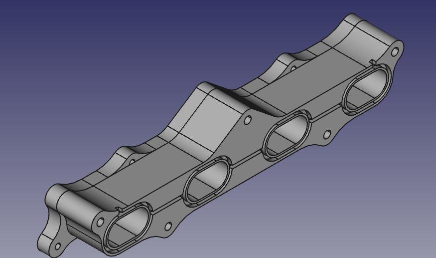

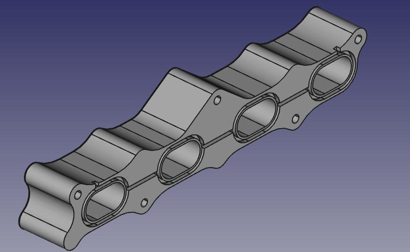

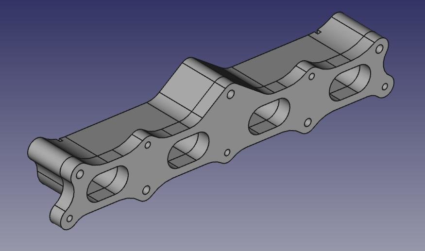

    I think this is it

    Looks great! Is it me or does the counter sunk holes appear uneven? I would imagine all the 3RZ bolts would need to be counter sunk into the 2TR side.

    They are definitely even lol
    The only two that probably need it are the top two corners, the rest clear fine.

    Good point. A draw back might be different length bolts but it's not a deal breaker.

    It’s set in 10 mm, metric bolts are generally in 5 or 10mm increments
