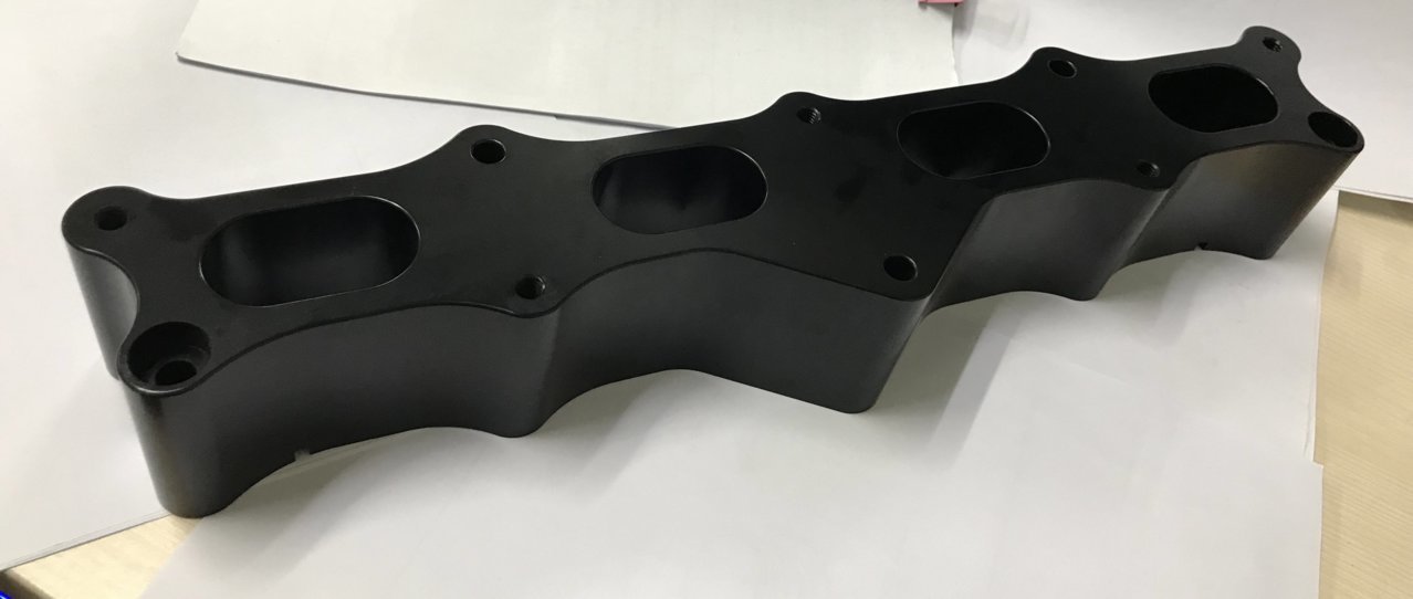

    A little ahead of schedule, waiting on production of other parts in order allowed for anodizing.

    Is that halls spacer or is that your own?

    Looks good. Have you had the opportunity to check for alignment with any of the parts you have?

    Mine

    Picture from machine shop, won’t get hands on it until nearly another week unfortunately
