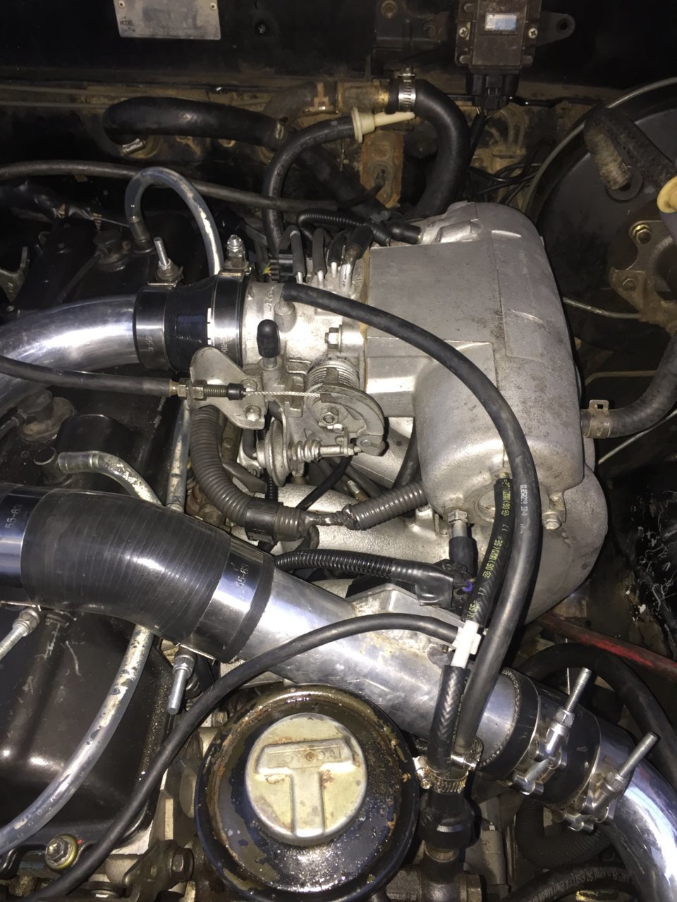

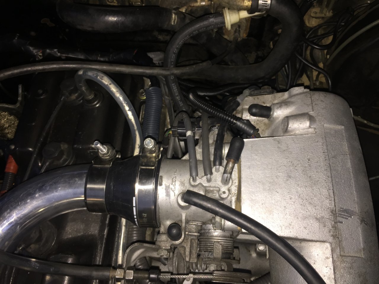

    Could you take a picture of your engine bay? Multiple if necessary, so we can see all of your vacuum hoses.

    I got some pictures. Just need to see if I can get them uploaded.

    Where does that blue hose on the catch can go?
