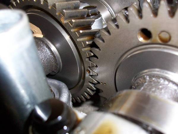

    Thought I would post my findings during overhaul here since so much is already covered.
    Issue: Main and rod bearings.
    When Toyota built the engine they matched journal sizes to one of three 'standard' bearing sizes. These are often referred to as micro-sizes. One crank may have a different size bearing on each journal. In replacing the bearings the Toyota Service Manual says to replace them with the same size unless of course you grind the crank. If you buy aftermarket (anything other than Toyota) bearings you can only get 'standard' which are an average of the micro-sizes or 'undersize' bearings. As pointed out to me, if your micro-size bearings are still in good shape you may have a better fit by reusing them than with an average size 'standard' new one. I was surprised that the bearings on my 3RZFE look brand new (no visible wear) after 185K. The crank doesn't have a mark but will be polished. There was almost no ridge buildup on the cylinders so I was able to pop the pistons out without any effort.
    I am doing the overhaul due to a minor loss in power and a measured drop in compression of nearly 50%. During a leak-down type compression test I heard air coming from the oil filler, indicating a loss through the rings. However, when I removed the head I found the valves mistimed by one tooth and a lot of black soot at the intake. This could have been my leak and I'm doing a whole teardown due to a mechanics screwup years ago when I had new exhaust valves installed due to pulling too heavy a trailer from Alaska.
    Something else to note: The exhaust cam has a driven gear and sub-gear. They both mesh with the intake cam gear but there is a torsional preload between the driven and sub-gear. This twist serves to quiet the timing train. The manual says to install a small 'service' bolt through holes in the gears before removing the cam to maintain this twist. You can install the cam without the twist and it will time and work fine, just noisier. I found mine in this condition. The holes were not lined up. I'll try to post some pictures.

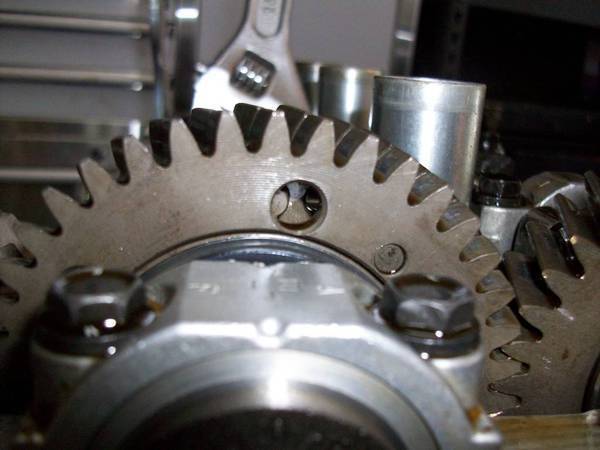

    Here is the bolt hole misalign.

    I encountered this problem when I discovered I needed to grease and oil the cam before installing it (when I went to the FSM for torque information). I forgot to replace the bolt before removing the cam to grease it, and the gears twisted. I put it back in shape by placing it in a vise (protected by wood on both sides), prying it over with a screwdriver till I could insert a bolt from the valve cover (it's not threaded all the way to the end, so it allows for a little more adjustment). It was a nuisance, but it is fixed.

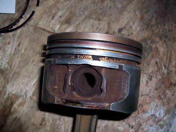

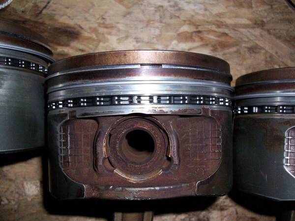

    New development: I measured the timing chains and it appears both are worn beyond limits. I was surprised. Toyota gives very specific (to the .0001) for length and for diameter of the sprockets with chain attached. The sprockets seem to have wear also. I don't have calipers that reach that deep so will have the shop measure.
    I don't remember the recommended replacement interval for timing chains and I vaguely recall that the chain and sprockets should be changed together.

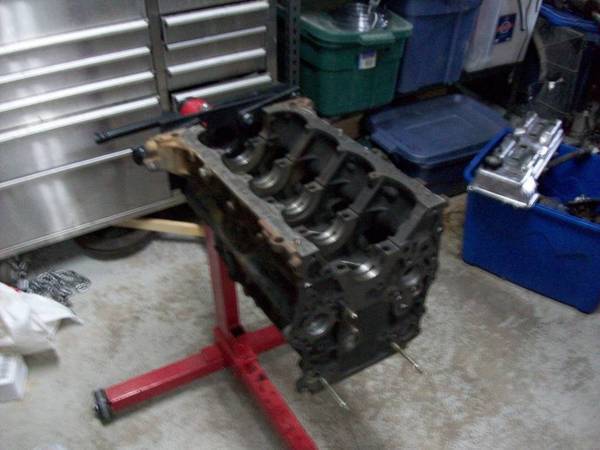

    Cleaned and ready for rings. The oil drain holes can be opened with a 3/32" punch or a piece of wire coat hanger. Some of mine were blocked entirely.
    I tried to add more than one picture and step to a reply but Int. Explorer keeps blowing up.
