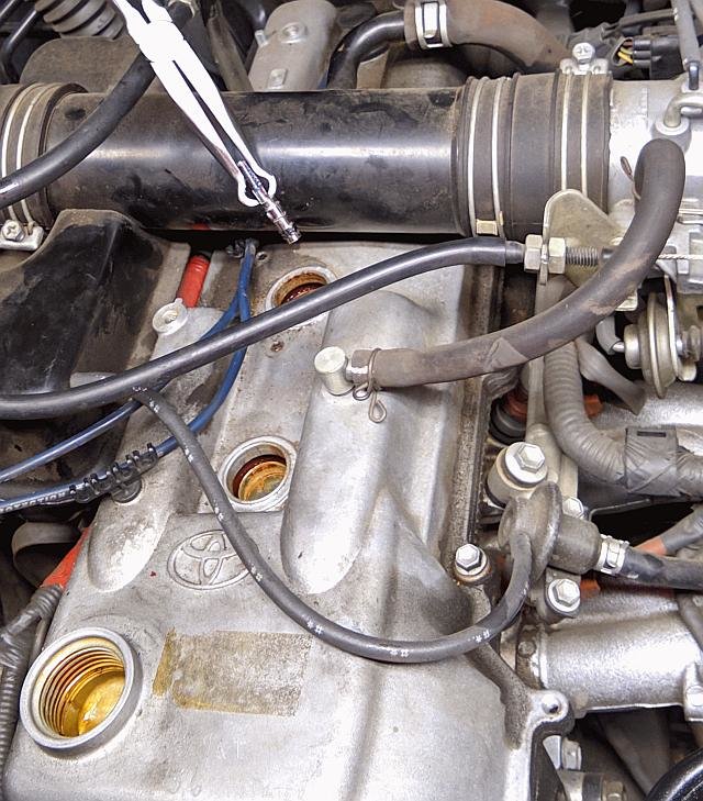

    Thanks. The whole thing with "specialty tools" is you only generally use them once, so, while they pay for themselves in that one use, it's best if they can be used at least twice! :)
    Thanks. Since I've never done either on a car I don't know if it's one of those jobs that has us remove the same parts. If so, it makes sense to check both the timing chain and valve clearance at the same time. But I'd rather NOT rip open a perfectly good engine either, if I don't have to (as I've never done it before).
    There are no symptoms whatsoever other than this sudden P0301 which turned out to be bad plugs or wires since that cleared it up instantly.
    I'm just worried that I might damage something if I overlook the chain and/or valves because I know they've never been checked in 200K miles.
    BTW, one "special tool" that I used "twice" was these hose clamp pliers, which I used to pull out the tip of the broken spark plug wire that was stuck on the spark plug preventing me from getting the 5/8ths inch spark plug socket on any of the plugs.
