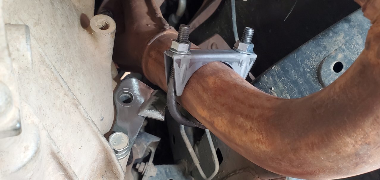

    I've fought with exhaust leaks on my 3rz as well.
    I replaced my cast manifold with a "mini tube header" that came on the later 3rz motors.
    https://www.pirate4x4.com/threads/2-7-3rz-mini-header-confusion.727560/
    From the beginning I had issues trying to get the EGR tube to seal up. OEM gaskets fixed that and periodically going back and tightening the bolts that hold it onto the intake and exhaust sides.

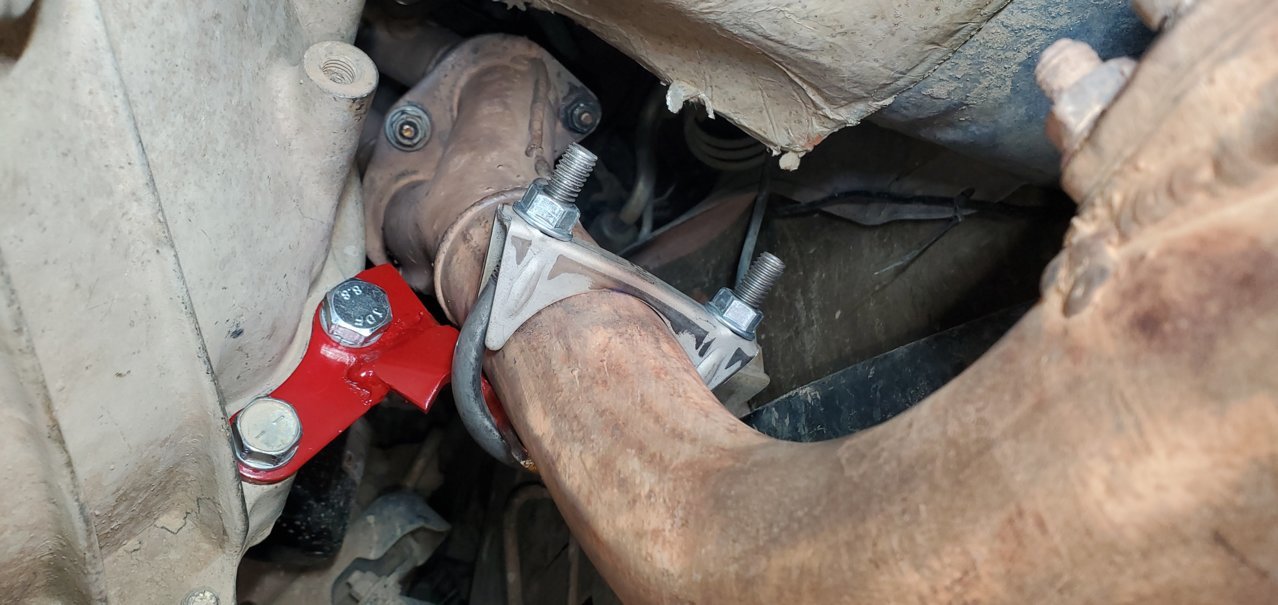

    When I redid my exhaust with the new manifold, I didn't put this little support bracket back on and over time it ended up creating a leak at the connection to the rear of my cylinder to the exhaust manifold (due to the engine twisting back and forth under load and then translating that force into the exhaust since there aren't really any flex joints).
    So I made a bracket of my own later down the the line to replace it and hopefully help.
    Also did OEM gaskets between the connection on the downtube to the exhaust manifold. I had issues with it leaking there too. the aftermarket ones you get for that spot are all terrible quality and don't last long at all.
    Use a piece of fuel hose attached to a wire with one end of it to your ear to probe around and try to find exactly where the leak is coming from.
    I hope that helps

    There is supposed to be a very similar bracket there right where your red fabricated one is located. I must be missing something.

    Yea I bought the OEM one that's supposed to go right there but it didn't fit since things had gotten kinda bent/twisted over time without having it installed. So I had to modify it to make it work.

    I thought about doing a flexjoint too, but never executed on that. I've now started to develop a crack on the intermediate downpipe even after reinstalling that little support bracket piece.....
    Do you have that little bracket that supports the intermediate down pipe installed?

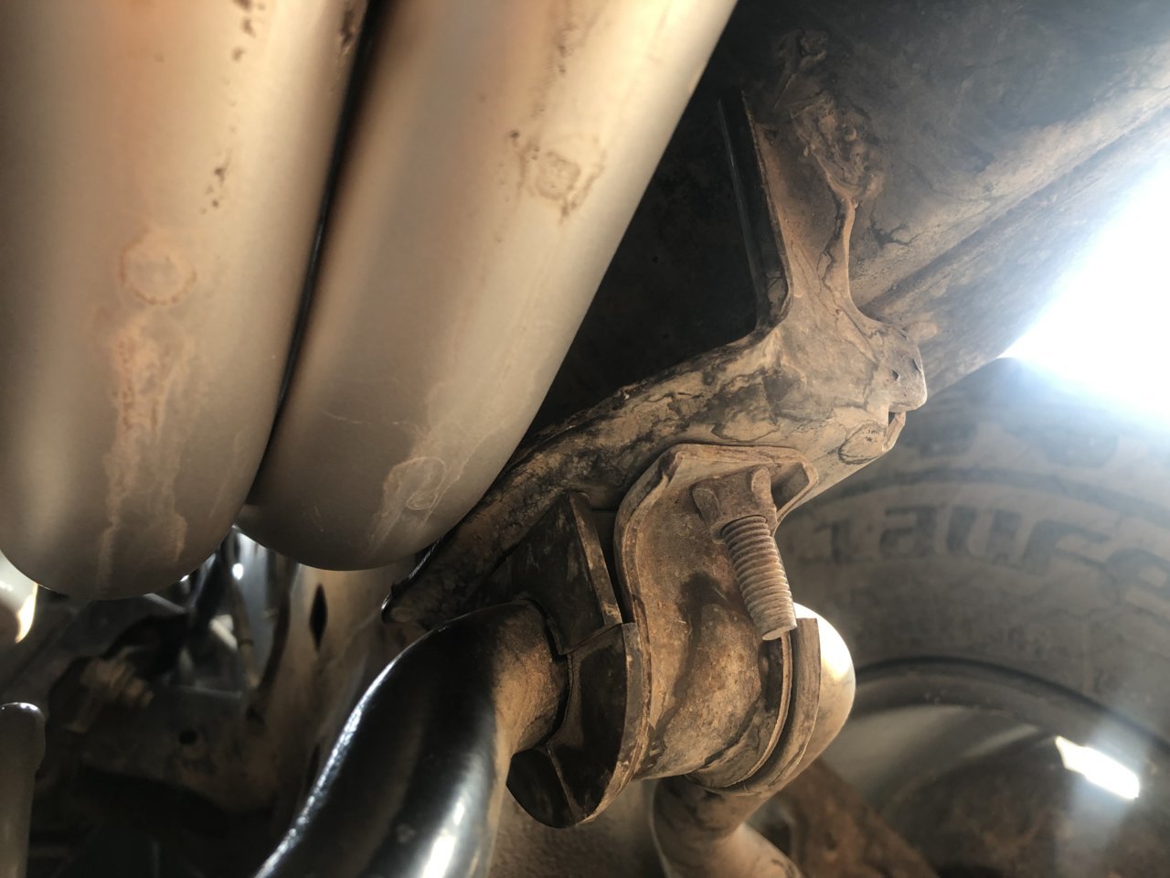

    I changed over to a long tube header and I’ve figured out the cause of my leak my motor mounts have gone out and your quad my header into my frame so LCE is sending me a new header and I’m going to change all mounts and hopefully that helps and if it still runs I’ll just put a dent in the pipe so it clears I know it sounds hoopty but at this point I’m tired of messing with it

    This is my current problem right now

    Do you have the little bracket there that supports that pipe? The one that mounts to the bell housing of the transmission
