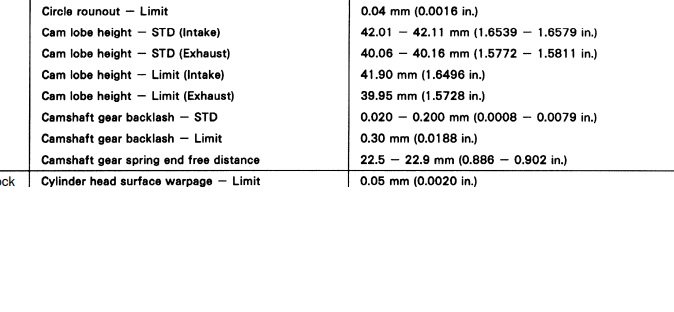

    Do you have measurements of the lobes out of curiousity?

    That I do not. I’ll see if I can dig up the specs in TIS
    Some of these older cars had those measurements hidden in documents

    I'm looking right now haha

    3.4 Intake 42.31 − 42.41 mm (1.6657 − 1.6697 in.) Exhaust 41.96 − 42.06 mm (1.6520 − 1.6559 in.) Minimum cam lobe height: Intake 42.16 mm (1.6598 in.) Exhaust 41.81 mm (1.6461 in.) If the cam lobe height is less than minimum, replace
    pic is for the 3vz camry.

    3vz should be easy to find if you found that

    Lobe height is one thing but the duration and lobe profile is what needs to be known. Only way to get that is a degree wheel and a dial indicator.
