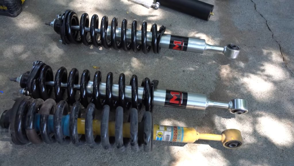

    I have a 4” rough county suspension lift M1 monotube with 285/70/17 tires and a KSP 2-4” UCA. I know most people are against RC but I’m needing help with an issue. My UCA are hitting my springs as soon as I take it off the jack. Can anyone give me any guidance on what to buy to fix this

    what lift specifically do you have? just the m1 shocks (which arent a 4" lift) or a full drop bracket lift that just so happens to have those shocks. either way most rough country shocks are improperly designed with an extended length too long so when suspension droops its goes too far and uca smashes into coil.

    Yeah need more info.
    Got pics?
