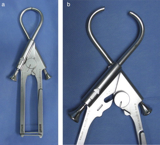

    Try to find one of these. It's an orthopedic surgical instrument called a percutaneous cerclage wire passer. It's basically a pair of pliers that are hollow. Would make threading wire through a sidewall really easy.
    They make these handheld ones that would be cheaper, but harder to line up just right.

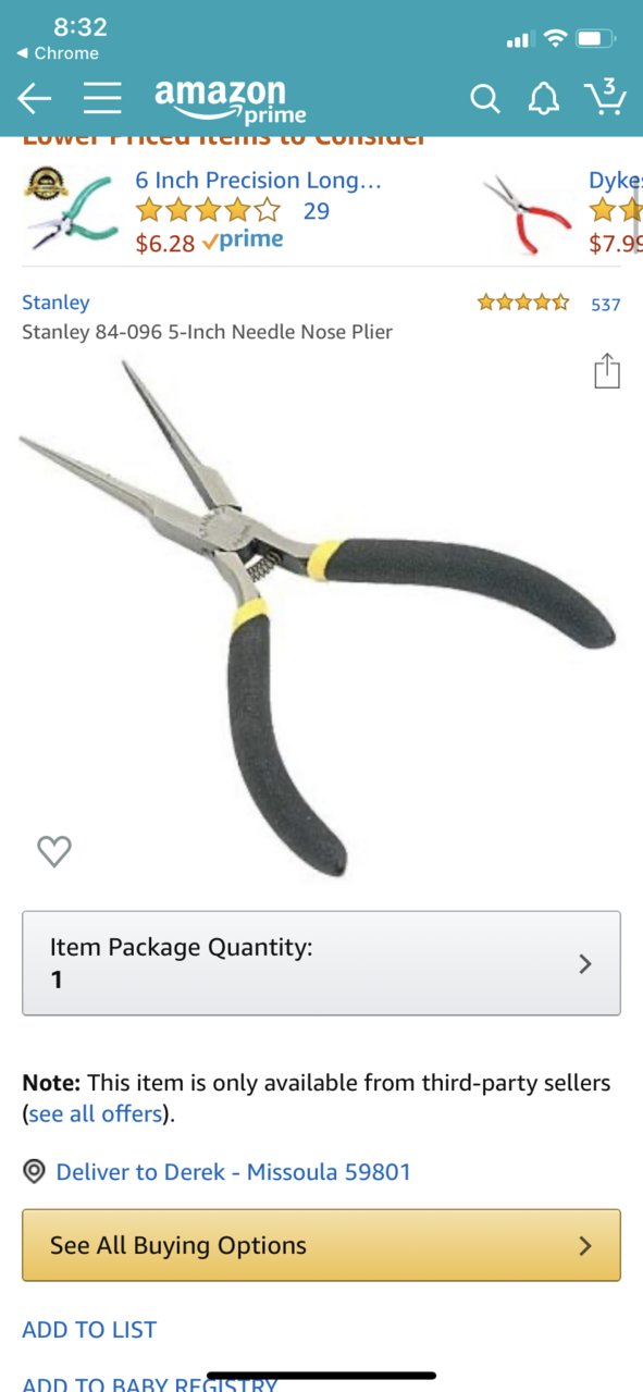

  19. Oct 2, 2019 at 7:36 PM
    #39
    DerekV87
    DerekV87 [OP] MT native exploring the wilds in the Tacoma.
    Sep 9, 2018
    #265674
    114
    Livingston Mt
    2018 Tacoma TRD Off Road Cement
    Xenon Dept HID Kit TRD Pro Grill TRD Pro 17" Wheels BFG KO2 265/70/17 De-badged Leer 180 Topper Topper LED lights Bed Platform LED Bulbs everywhere except interior Clazzio Leather Seat Covers OCD Center Console and Glove organizers Phone Mount found on Etsy Ultra Gauge Subaru Tweeter Upgrade AC Drain Mod Yellow Fog Light Bulb Bed Rug Tailgate Cover
    These appear to be ideal but no luck finding on eBay.
    you’ve got me thinking... even one of these narrow pliers would be very helpful for the task.
