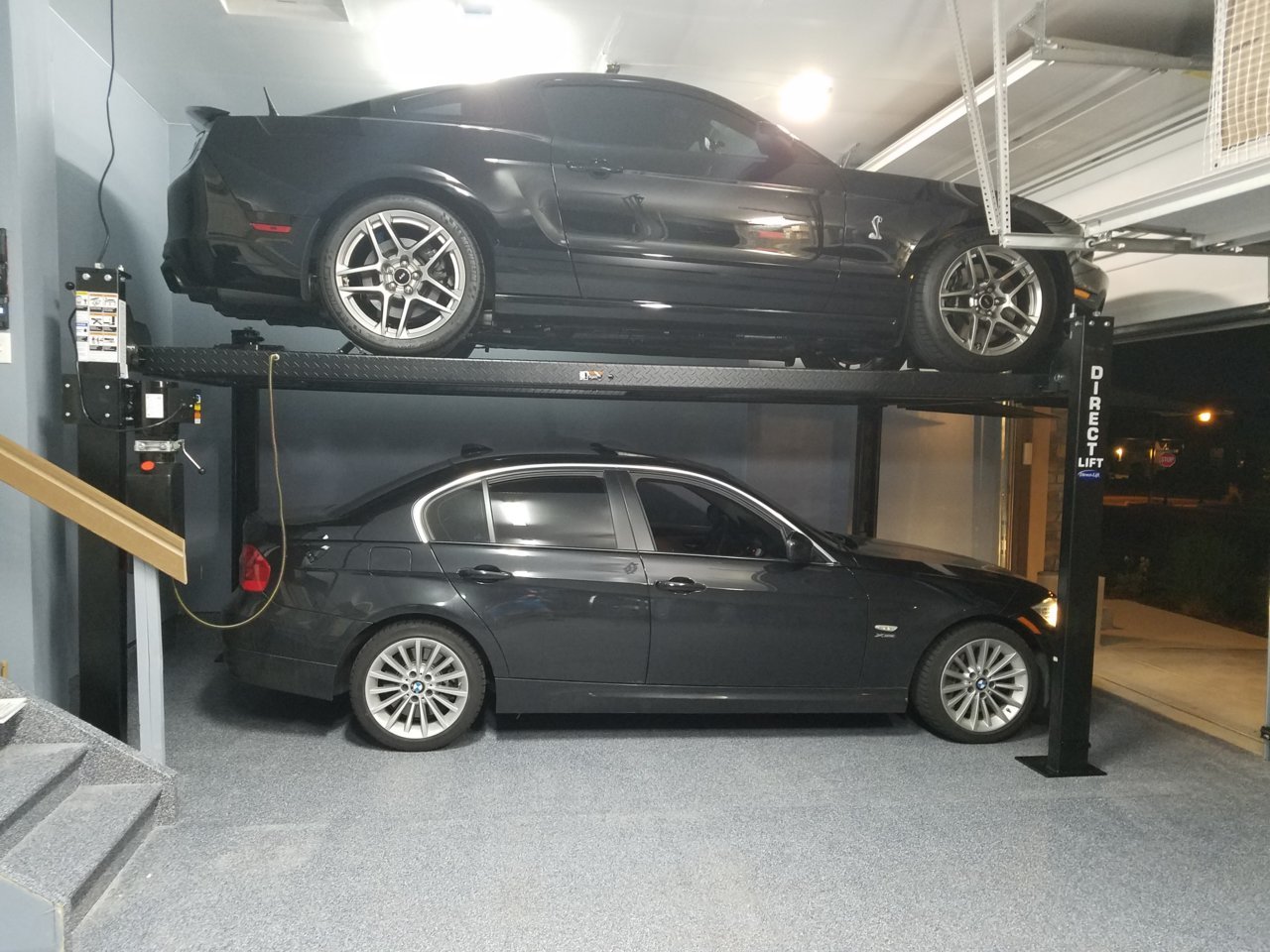

    Having a lift in the garage makes maintenance easier and a lot more convenient!
    No pics of the Tacoma on it but, obviously, it can't go quite as high as the Shelby or BMW.

    Soooo much want. Damn, that is nice Norton!:drool:

    If you have the space, they're more affordable than most folks think. Due to space constraints, I went with Direct-Lift's Pro Park 8S. It's ALI-certified (important for safety). Delivered and installed, it was $3K. I added a Pro Jack 3500, for another $500, bringing the grand total to $3.5K.

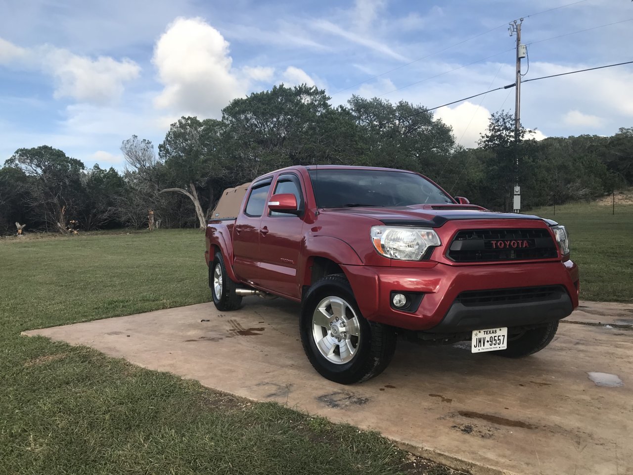

    What is the black strip right above your grille on the hood? I kinda wonder about doing that on mine.

    That sir is a bug deflector. It is the stick on type.. previous owner installed it, i like it personally so i left it on. Some of them stick up, but this one sits flat
    Made by AVS. I believe the acronym stands for automotive vent shade or something like that
