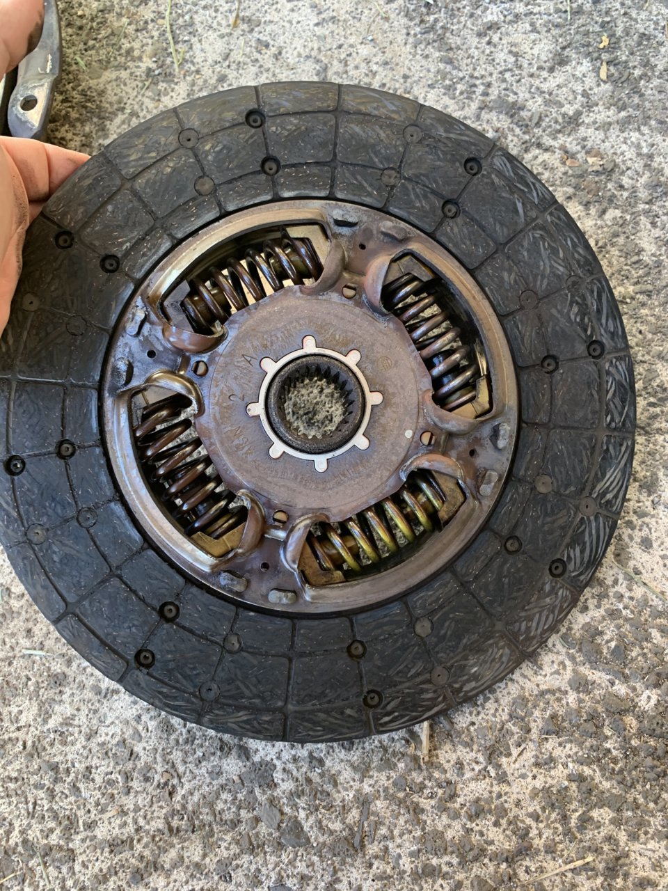

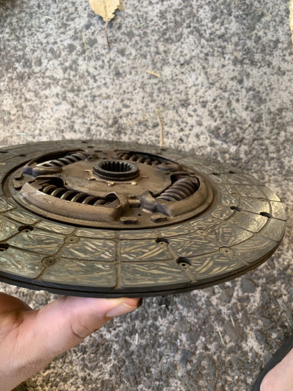

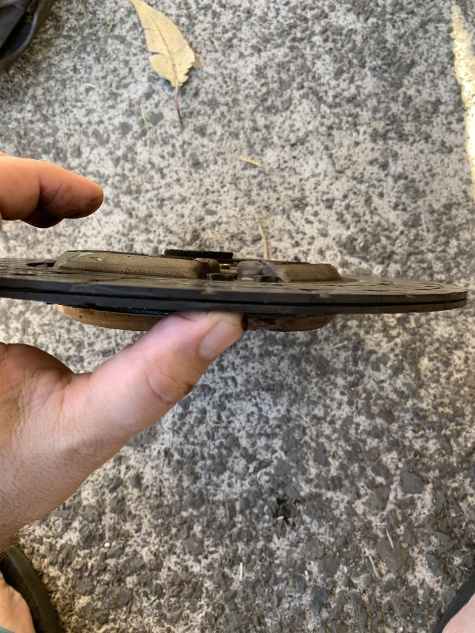

    Btw, here’s what my stock clutch had left on it. At 165,000 miles. This thing was AWESOME, towed many things all over the place, taught two other people how to drive stick, and I always drove it like a stole it (btw F*CK thieves/meth heads that steal instead of applying themselves as the awesome mechanics they could be -fearless, energy- to earn their snuff), but never abused it.
    8BB837E1-C19A-4DED-AEF6-CA6F486CCDDD.jpg 8BB837E1-C19A-4DED-AEF6-CA6F486CCDDD.jpgE963EED3-4D92-469E-A09A-01B2D87FF65E.jpg E74EA014-3926-49BC-B95B-CF482FD15731.jpg
    I recall reading once long ago that Toyota included tougher clutches and the engine oil cooler for the towing package. Engine oil cooler was a FANTASTIC idea which we have all seen, but still never heard anything else in regards to the clutches being tougher.
