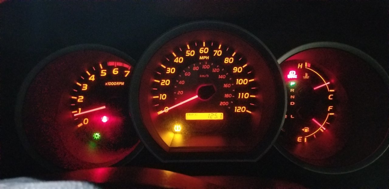

    I would agree that the cluster has been replaced with a later model.
    Pic of my 07 TRD Offroad for reference at idle for a few minutes

    Looks like your truck is mechanically sound. The instrument cluster is not. Your engine would have been toast at 6500 rpm with stock internals.
