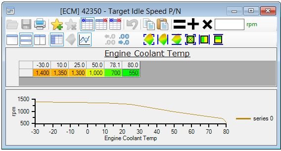

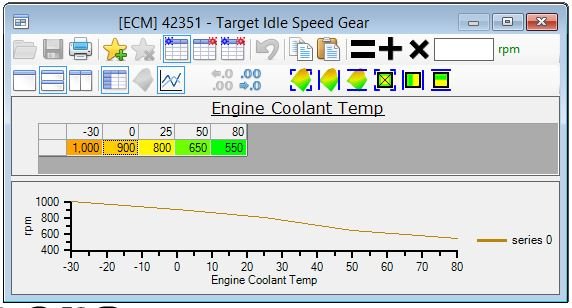

    These are the ECU's targeted idle speeds based on coolant temp.
    Target Idle speed when in P/N:
    Target Idle speed when in Gear:
    There's also a Idle speed adder that is based off a time switch. This adder, from the factory adds 200RPM for 1sec to the above tables after initial startup.

    Is the x-axis deg F or deg C? Looks like C.
    JustDSM[QUOTED] likes this.

    Oddly, it’s unspecified. I’ve found it to correlate with Celsius in testing however.
