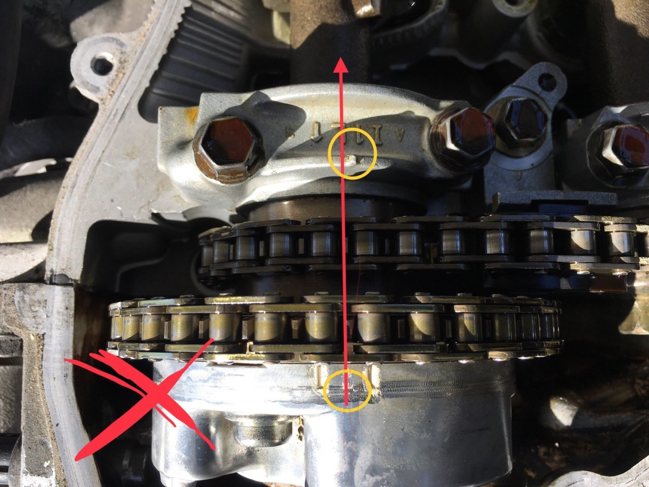

    I replaced the head gaskets on my 4.0.
    Now I have no signal to the fuel pump relay.
    Also want to confirm the timing. Any tips ? Thanks in advance.

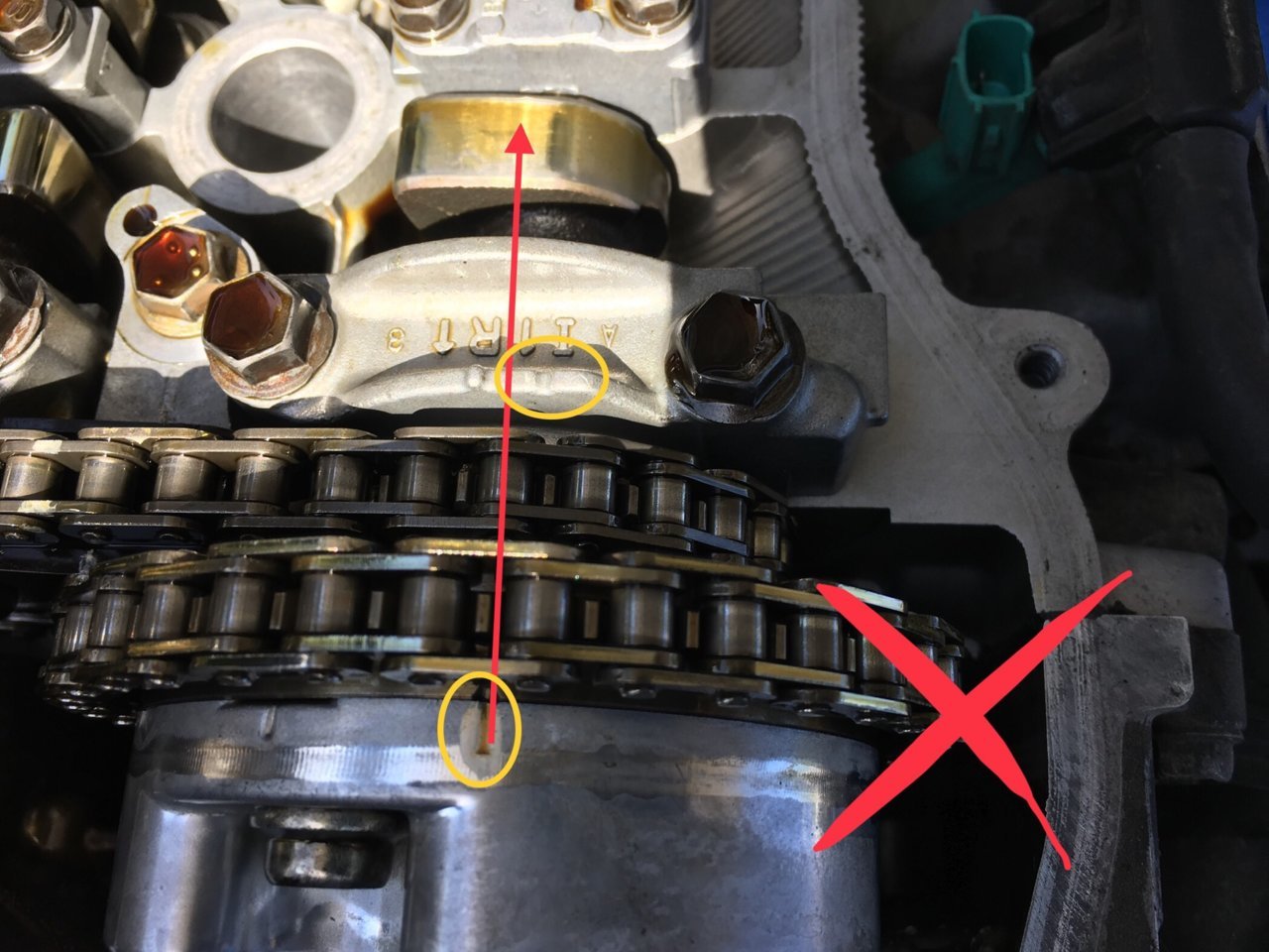

    Timing mark should be the as follows. Bank 1 is the single mark lined up with the indented mark on the cam cap. Bank 2 is the center of the the double marks on the cam phasers with the pointy tip onto the cam cap bearing. The exhaust cams should have the dot on the sprocket line up with the tip on the cam bearing cap. The crankshaft key should line up with the angled line going directly behind the crankshaft sprocket.
