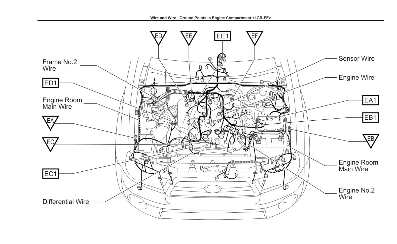

    2015 TRD Offroad: I have both knock sensor plugs removed and I've followed the harness back to where it exits the V and turns toward the passenger side. I cannot for the life of me see the plug that goes to the main harness so that I can unhook it. If anybody could offer some direction here it would be greatly appreciated. My apology for starting a new thread. I posed this question earlier today in the 4.0 intake manifold removal thread that I started however I've not had any replies so I figured I'd bug you all again. Thanks, Homespun
  2. May 13, 2024 at 6:07 PM
    TnShooter
    TnShooter The TacomaWorld Stray
    Sep 2, 2010
    #42625
    20,898
    Deogee
    07' TRD Off-Road, Auto
    STOCK

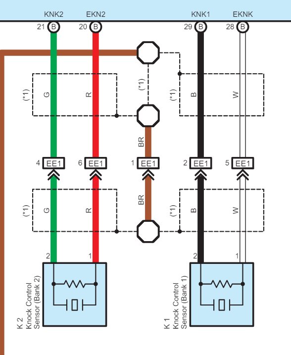

    EE1 Connector below

    Thanks for the reply. One thing that I noted was that he listed the two 16341-AD010 water out gaskets yet never mentioned having to remove that housing at the back of the engine (6 bolts total). That would give a little bettter access but the darn plug is still buried back there. I thought that the lower middle bolt on the water in assembly was a bear to remove but this plug is proving to be just as challenging if not more so.
