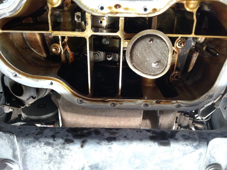

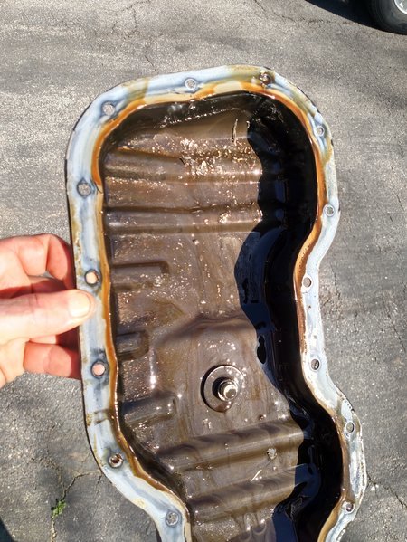

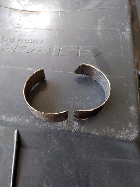

  14. Mar 12, 2017 at 9:28 AM
    jksmith
    jksmith [OP] Member
    Dec 26, 2016
    #205691
    18
    Joel
    2008 X-runner
    Here is the latest, been avoiding it because I was afraid of what I was gonna find. #5 rod spun, next step is pull it and send it to a machine shop. Hopefully the crank can be saved.
