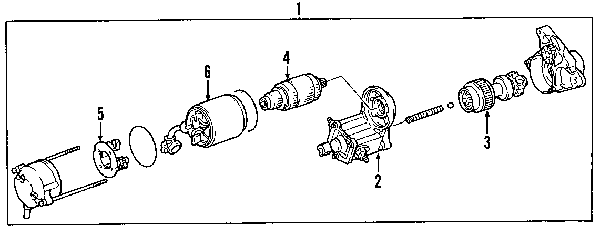

    Getting it out was not too terrible. We put the truck on jack stands and I took out the 2 bolts and 3 wires holding it in place. My buddy opened up the left front wheel well and grabbed it from there. Eventually he moved to the hood while I held it from underneath. It came out pretty easily through the hood.
    Prior to replacing the brush holder, the truck would not start at all. Just the click and then nothing. Since replacing it, the truck starts right up about 90% of the time. Occasionally, it will click and then start or I'll have to turn the key to off and try all over. I'm starting to think that I may have to replace the plunger (Part #4 in picture) or maybe just get a whole new/refurbished one.
