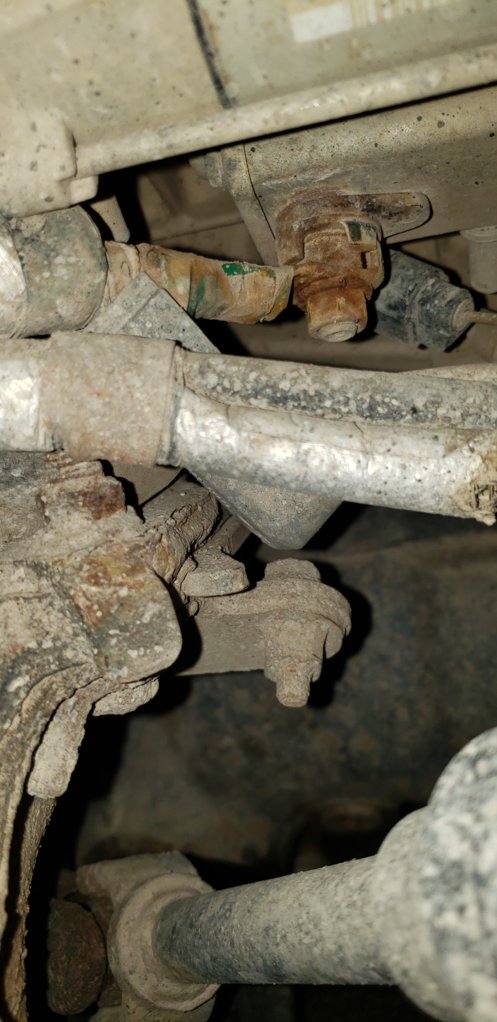

  17. Apr 4, 2025 at 8:44 PM
    #37
    Waasheem
    Waasheem The catholic radio bear
    Jun 26, 2019
    #297494
    2,812
    Waasheem
    2007 xrunner
    This connection doesn’t look good.
    Disconnect the battery first. Take this nut off, clean the lug and its mating surface on the starter. Reassemble, see if the problem goes away.
    winkel and Pigpen[QUOTED][OP] like this.
