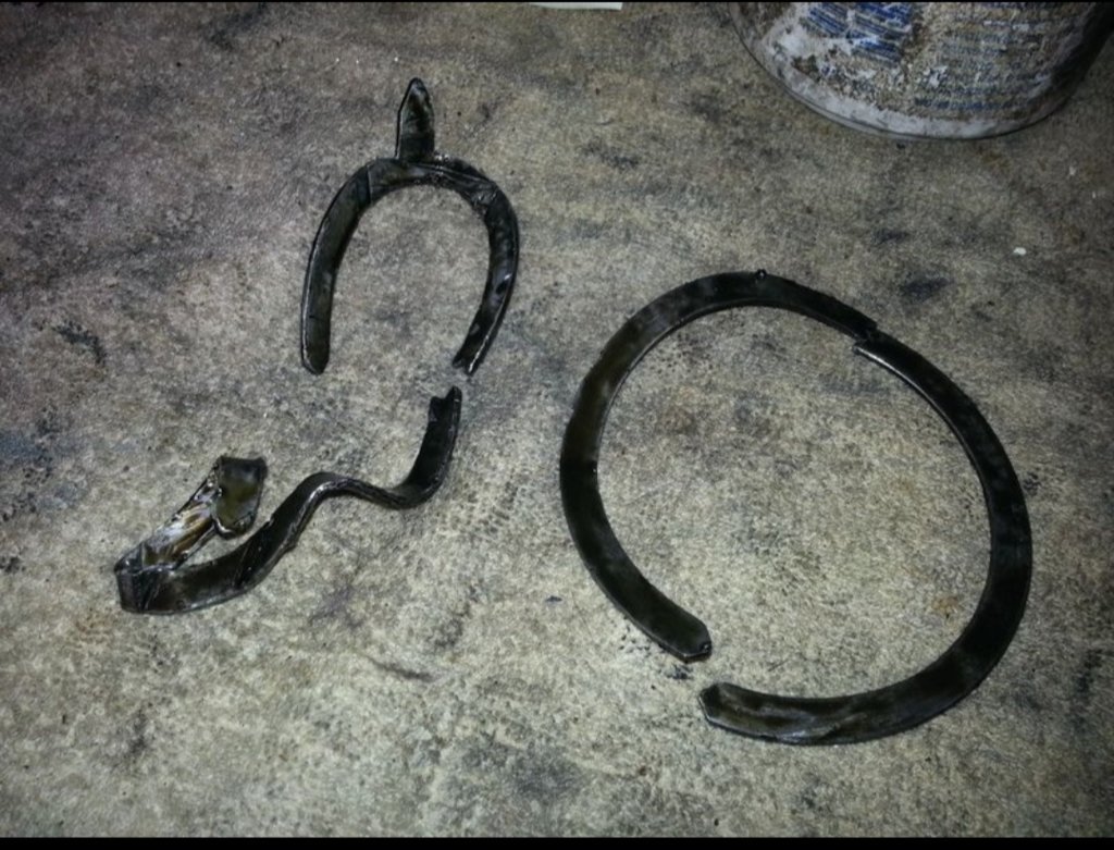

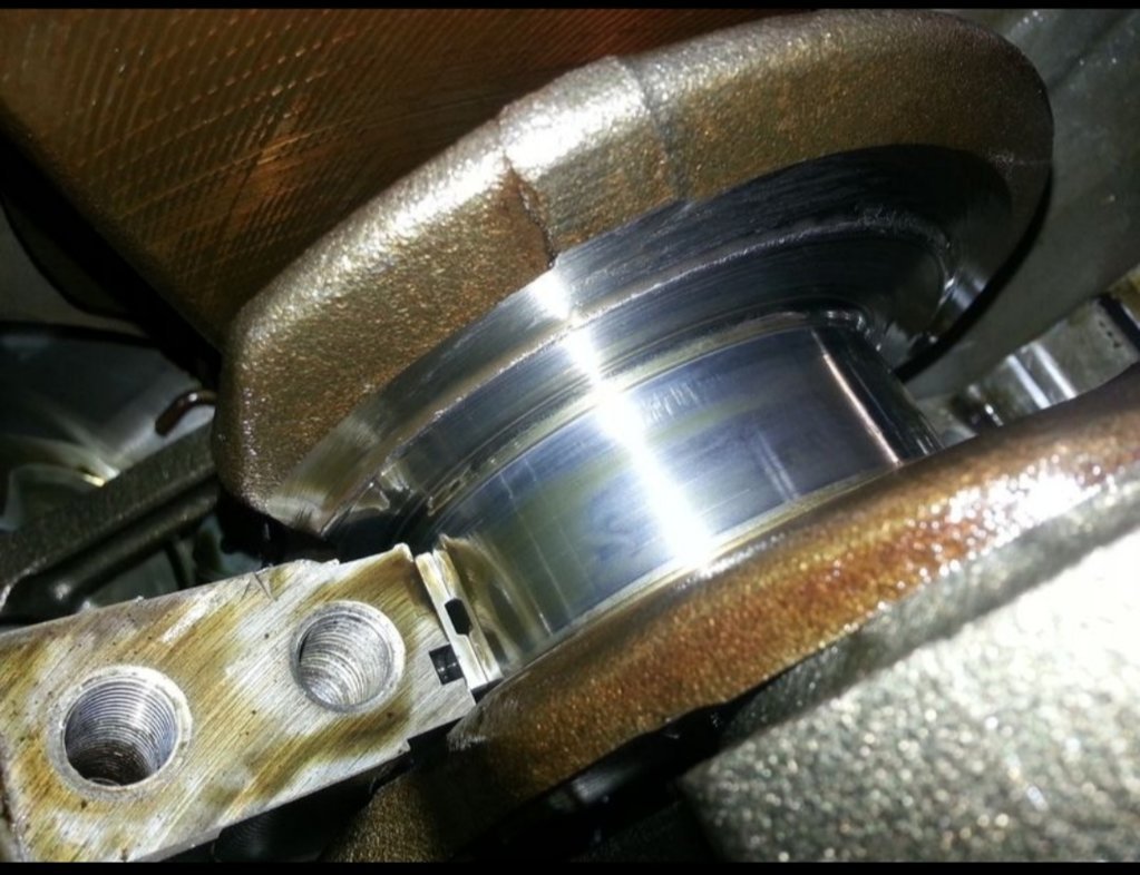

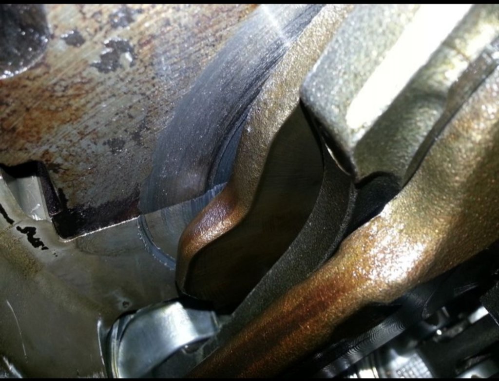

    Aaaactually.....sooo, I had a thrust bearing get flung out some how. Drove for a while. Even did a track day on it. Both sides. In the oil pan. That's a lot of front to back play. There was enough room everywhere for the crank counter weight to use the main cap as the thrust surface.
    Pigpen[OP] and b_r_o[QUOTED] like this.
  11. Apr 23, 2025 at 7:46 PM
    #51
    Torspd
    Torspd Tor-nication
    Sep 18, 2009
    #22958
    26,296
    Tor
    The Great America!
    MMVI 4.4L 4x4 Access Cab
    Torspd Custom Turbo kit [] Borg Warner 9180EFR Turbo [] Haltech Elite 2500 [] TiAL Q BOV [] TiAL V44 Wastegate @ 15psi [] CP Pistons [] CP Carrillo Rods [] ARP Head studs [] ARP Main Studs [] ARP Header - Head Studs [] Ported Heads w/ 1mm oversized valves intake/exhaust [] Brian Crower Forged Stroker Crank [] Darton M.I.D. Sleeved Block [] Kelford Camshafts [] Torspd 160* T-stat mod [] APR Large Fuel Rail [] Walbro 460 LPH E85 Fuel Pump [] FueLab FPR [] APR T56 Conversion Kit [] KP RACING Built T56 [] McLeod Racing Custom Twin Disk Clutch [] One Piece Aluminum Driveshaft [] MGW Shifter [] Custom lowering kit [] Ohlins Front Coilovers [] QA1rear shocks [] Custom Ron Davis Radiator [] Dual SPAL Electric Fans []
    JB weld fixed it. :cool: Seriously

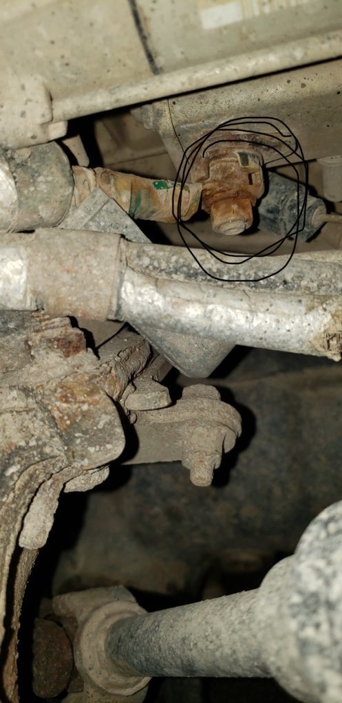

    It happened again today. I was a long way from home. Went for a nice walk, hour or so, truck started right up. Was driving out, a bit slow going, and a couple miles down the road it died shifting from first to second. That happen twice today and once 2 days ago. Dying on the road is new. That bothers me.
    Of the many times this has happened, the one unchanging variable is that it stalls when the clutch pedal is pushed in - with the exception that it has refused to restart after just plain stalling it a couple times.
    Is it possible that the fuel "filter" (sock) is gummed up and causing this? I just put a new fuel pump relay in this evening when I finally got home, and I have a new Denso fuel pump ordered.
    I was really hoping that the crankshaft position sensor would resolve the issue.

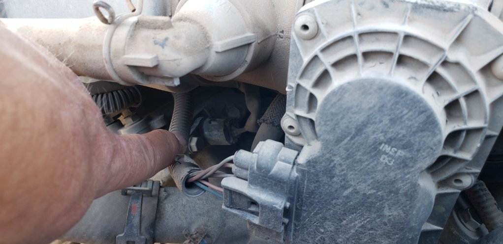

    Heres a seemingly random thought, but not random at all. I was looking at the timeline of when this first happened. Clutch replaced Feb 12. Problem first occurred March 16. Secondary air injection warranty work done by Toyota on March 18. I don't get to blame Toyota. That got me thinking. It's very likely that on the very day I first experienced this problem, I may have removed my SAIS bypass/ override (whatever you want to call it) from slyfox75. This kit was supposed to stop the SAIS pump from running(it did not). As I was saying, I removed this kit just before having the warranty/recall work done. The installation of said kit required connecting a wire to the starter relay. The way this was done was to just jam a small gauge wire into one of the relay connections.
    My question is... Could slightly opening one of the connections on the starter relay in the fuse box cause any or all of my issues we're discussing? The timeline fits perfectly.
    I bent the tabs on the rely slightly to improve the connection, in case this is the problem.
