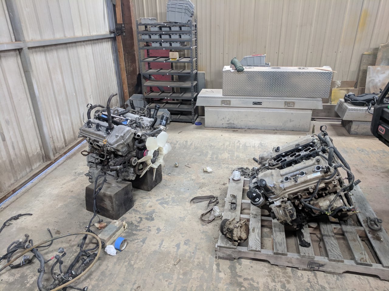

  7. Aug 18, 2020 at 1:33 PM
    bobsuruncle
    bobsuruncle PhD in voiding warranties
    Feb 17, 2015
    #148863
    7,339
    Bob
    Fall City, WA
    06 TRD OR DCSB
    ARB bull bumper Warn XD9000 Icon 2.5 EXT Road Armor rear bumper Archive Garage shackle flip FJ/T4R tcase 4.30 gears Dirty5’s T4R rear axle swap w/disc brakes New frame from Toyota under EWP
    I swapped a 2010 motor in to my 06 no problem.
    2010 on the left, my 06 on the right.
    2012+ have the added piping above the exhaust ports, I hadn't seen anyone that had done it, so I stuck what I knew would work.
