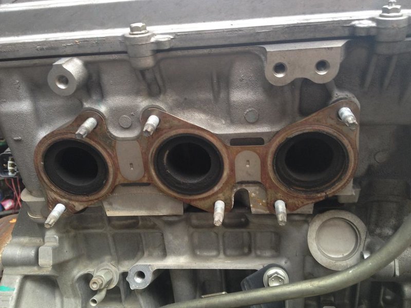

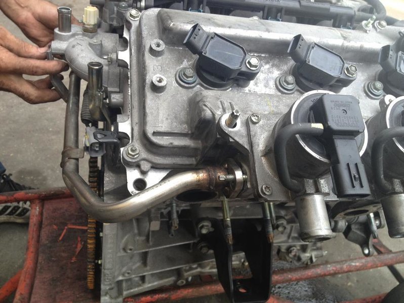

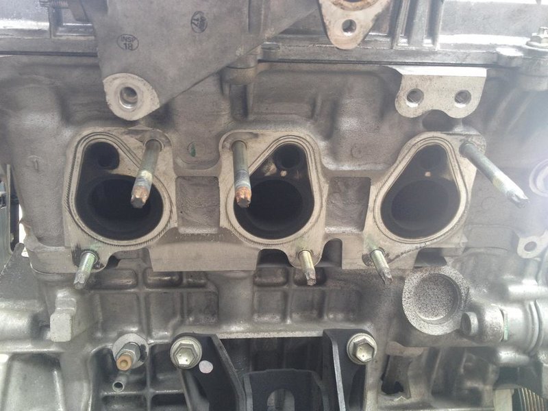

    I'm probably wrong but from how I'm looking at it, you're gonna need the 2012+ manifolds, or headers for a 2012+ and run a block off plate on the top pipe. Also your passenger side valve cover to eliminate the SAI pumps as someone previously said earlier.
    Here's how the SAI equipped1gr-fe manifolds look. The SAI tube at the top, and the pear shaped exhaust ports.
    And here's how non SAI 1gr-fe exhaust looks. Round exhaust ports.
    SR-71A and Oreo Cat[QUOTED][OP] like this.

    just gonna block The holes on these.. way easier and cheaper than Toyota brand headers and will add some power in the processs..
    Will turn this into a more informational thread for those with a 05-11 engine going to a 12-15 engine when I get it in and working 100%

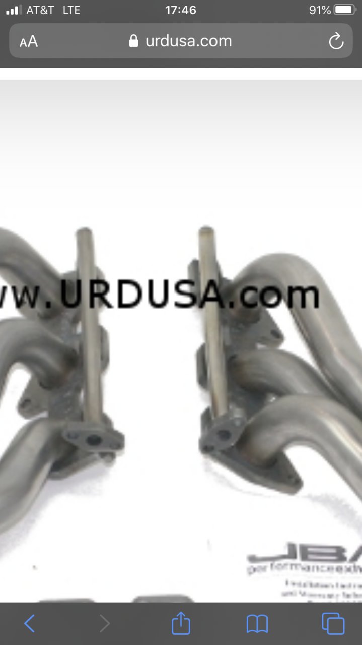

    Do you have a link I can’t find where any that specifically say they are “equal length”

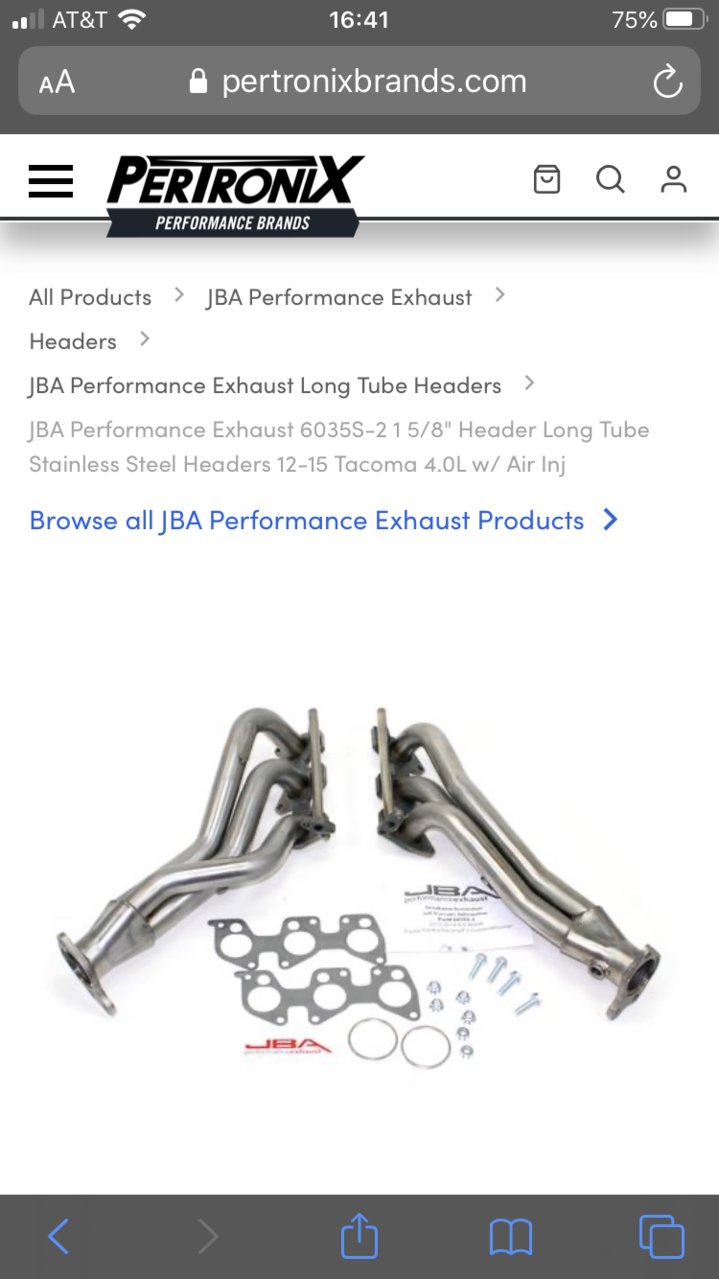

    Yeah I’m just asking to see if the headers cover the holes on the engine block That are for the air pump because it seems some other headers on the market have extra parts to be compatible with that pump. I just don’t want to buy these and have them not cover those holes on the block
  20. Aug 20, 2020 at 5:50 PM
    #40
    Oreo Cat
    Oreo Cat [OP] Worst Member
    Sep 19, 2016
    #197755
    5,356
    Coeur d’Alene, Idaho
    Nvm I found it. “Not compatible with 12-15 engines”
