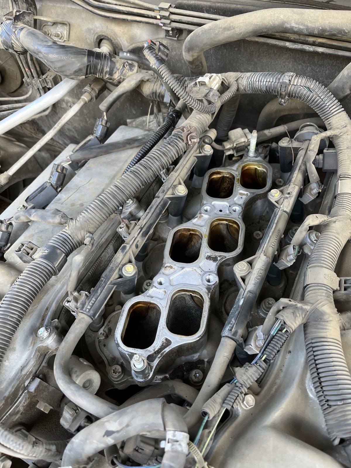

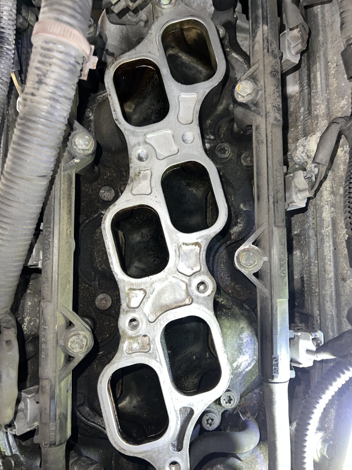

    So it’s been 3 weeks since I fixed the truck and it’s been running great. I noticed when replacing the valve cover gaskets the coil boots were fragile and tore easily when cleaning the oil out of them from leaking valve covers I ordered Standard Motor Products part# 8220-05337723 it’s a coil boot, spring, and gasket rebuilt all the old coil packs I thing looses it’s resistant for that many miles so the new one definitely helps. When I took the upper intake off to remove drivers side valve cover I noticed there was oil residue going to the cylinders especially 5 and 6 the ones with misfires so I when ahead and cleaned it and replaced the pcv valve with genuine Toyota it was about $7 when you order online at their website to pick up at your local dealer put it back together and viola no more misfires

    So a bad pcv was the culprit?

    Very normal, I had a truck apart with around 100,000miles/160,000kms that looked worse.

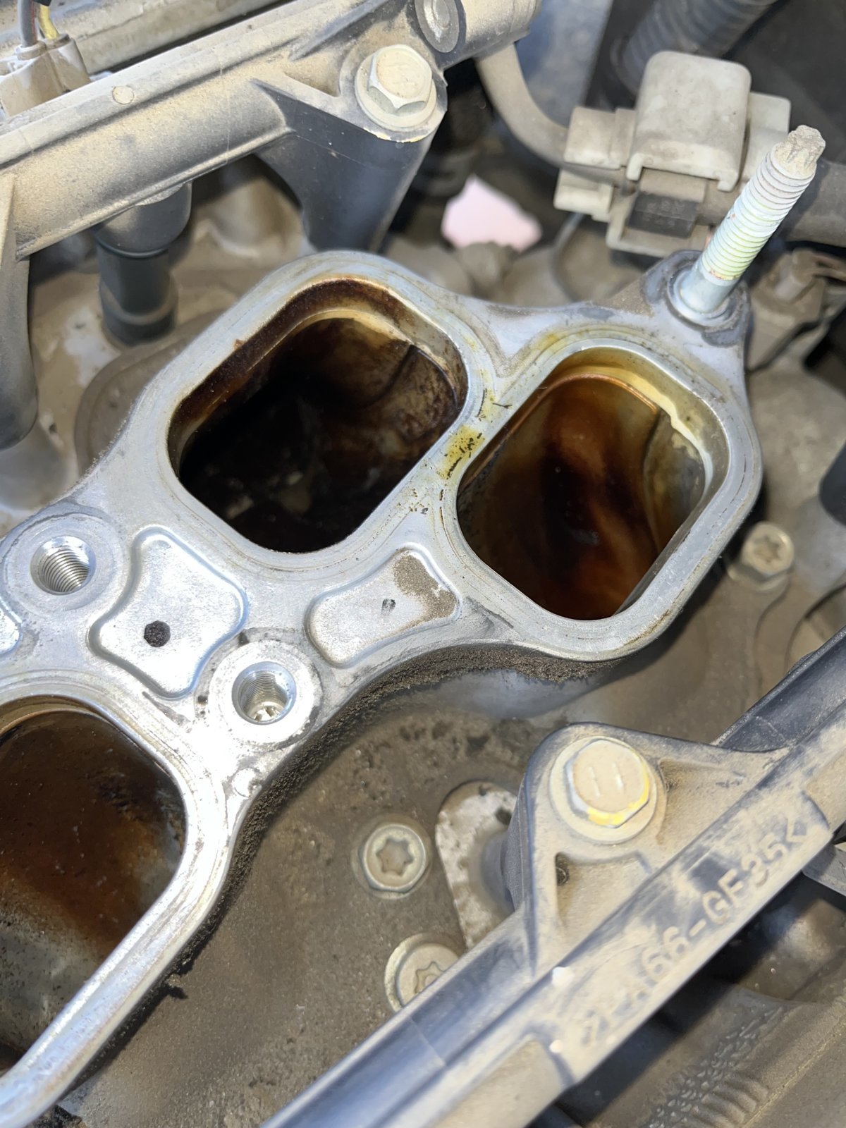

    Ok, I gotta share too. This was somewhere in the 490s I think (mileage). I just wiped inside each port as clean as I could, this image is before I did that. was an oily residue in each.
