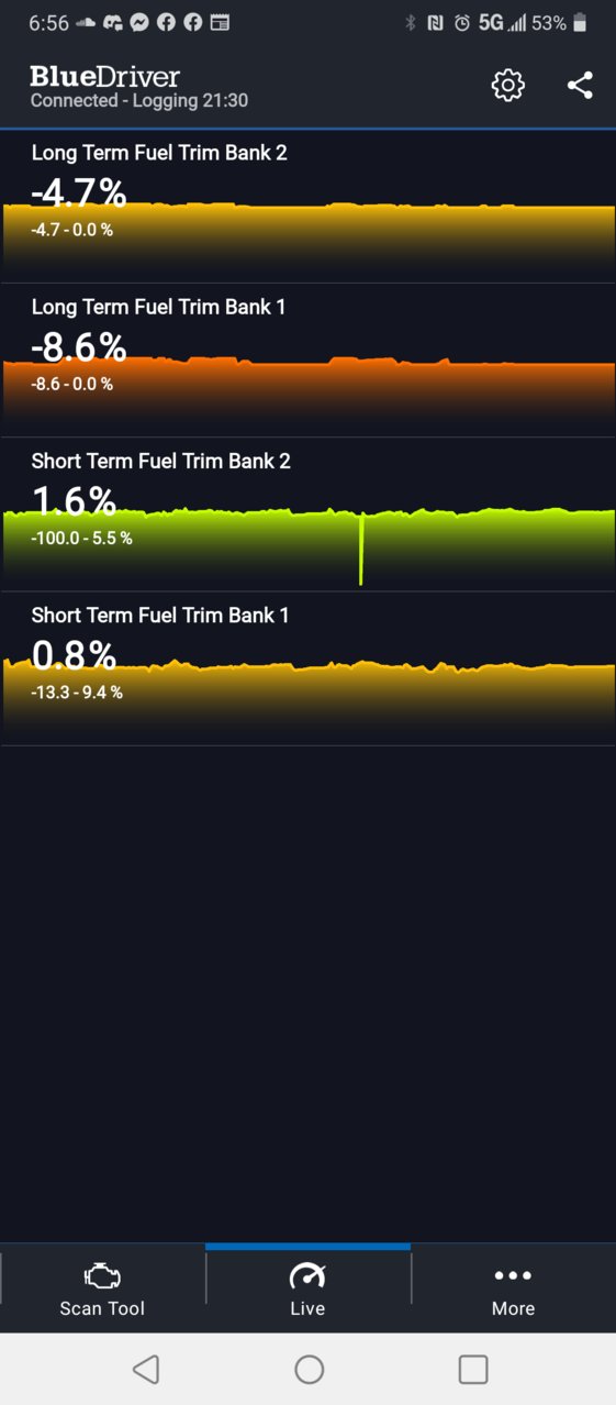

    Buddy of mine checked the fuel trims and the truck is running rich he has a screenshot of it so when he sends it to me I’ll
    Show you
    Long term
    bank 1 -4.7%
    Bank 2 was -9%
    Short term
    Bank 1 -13%
    Bank 2 -18%
  6. Feb 6, 2022 at 2:53 PM

    You have a fueling issue on both banks. Just as I suspected. You'll need to check fuel pressure. And my money says it's your fuel pump. The chances that both of your AFR sensors are bad is pretty slim, but still never outside the scope of possibility.

    but ya so what we noticed with the trims is in town driving, idle, and coasting it will spike but highway under load is fine
    here is a pic of the fuel trims btw

    All signs to me point to the pump. It's likely it has an inability to keep up with low fuel demand but once the truck gets going and demands more fuel it can keep up just fine. And even then, fine is a marginal thing because bank 1 is still past what normal values need to be.
    You have ruled out the MAF correct?
    If you have, check fuel pressure.

    Cleaning a MAF will do nothing if it has lost it's calibration, which at your mileage is a very real possibility.
    Usually the most common MAF failures to me display in the high 20's to 30's as far as fuel trims go, but given that you are lower than that, I'm almost positive it is not that. That is not to say, however, that your MAF is indeed not failing and emanating its failure in a lesser way than I have usually seen it.
    The issue is both of your banks are being affected more so when air and fuel demand is low (idle) so whatever is causing that needs to be something that affects the delivery of fuel on both banks (e.g fuel pump, MAF, fuel injectors, ECT, fuel pressure regulator, things like that)

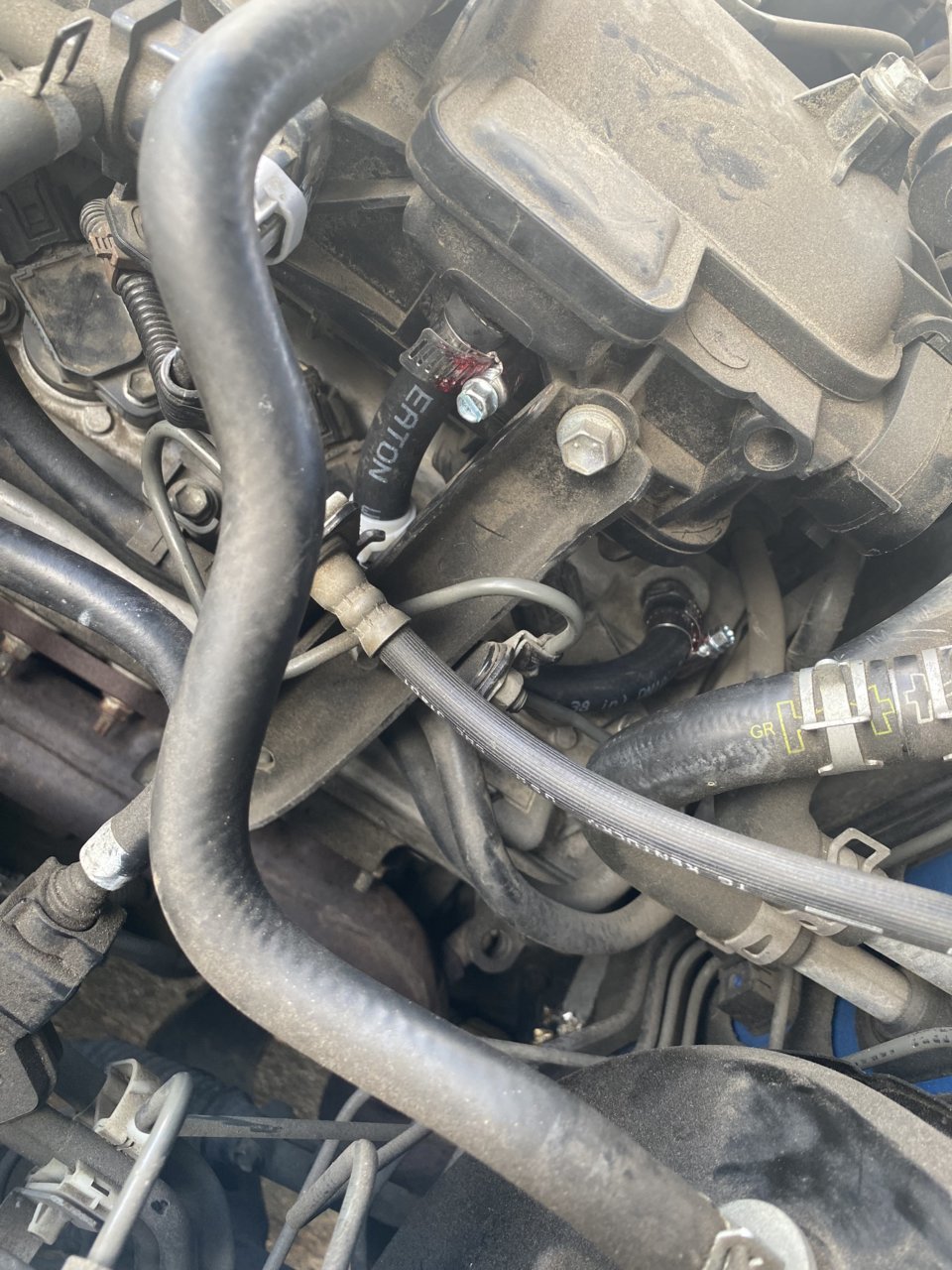

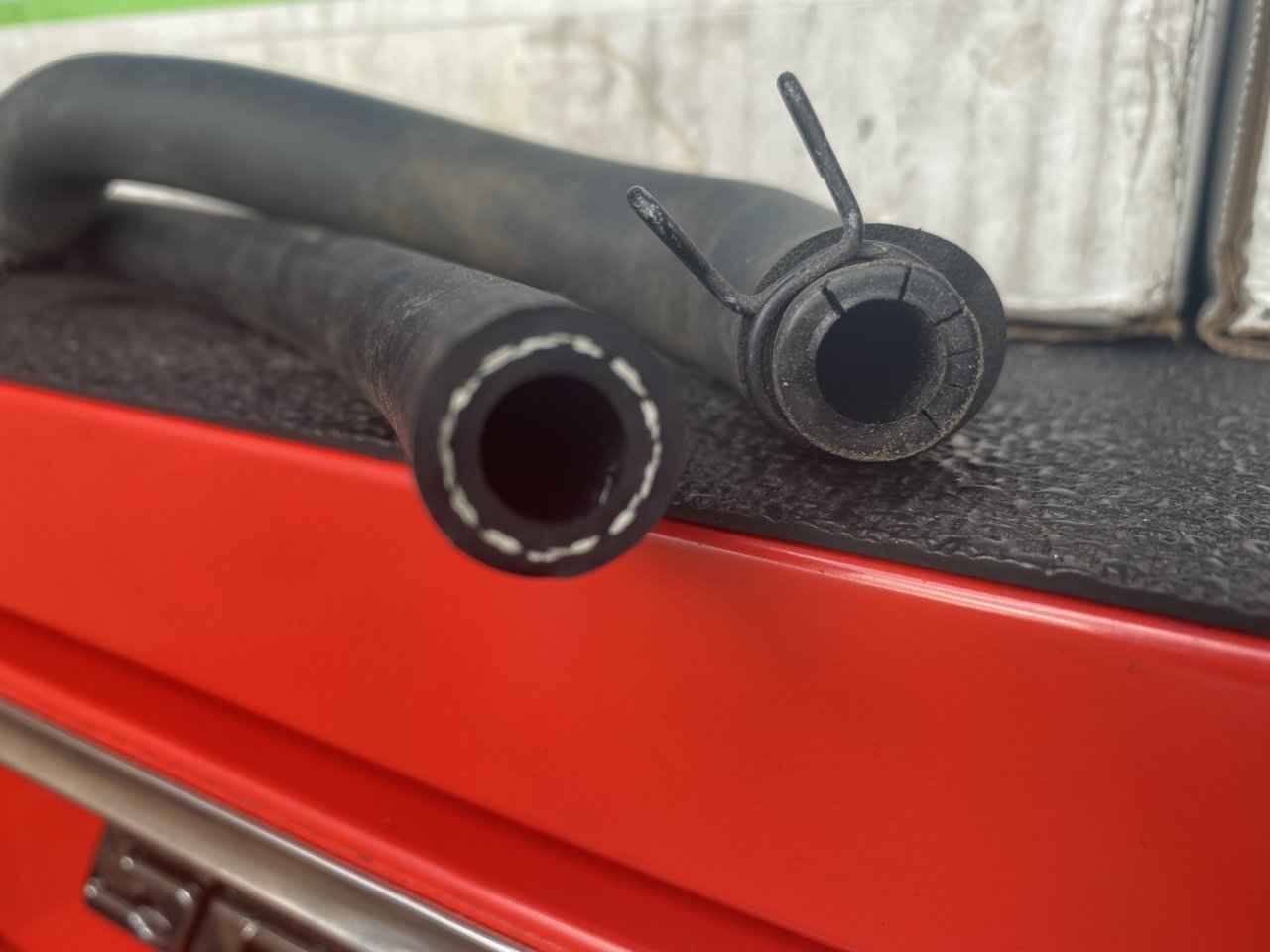

    My fuel trims were off, I found the pvc hose all cracked and loose when I replaced the pvc valve. Instead of going back in with the Toyota formed hose I used 3/8” oil hose & worm gear hose clamps. Look closely, where the new hose wants to rub on a bracket I wrapped it with a zip tie to prevent wear. I’ve been meaning to recheck the trims but haven’t gotten around to it yet.
