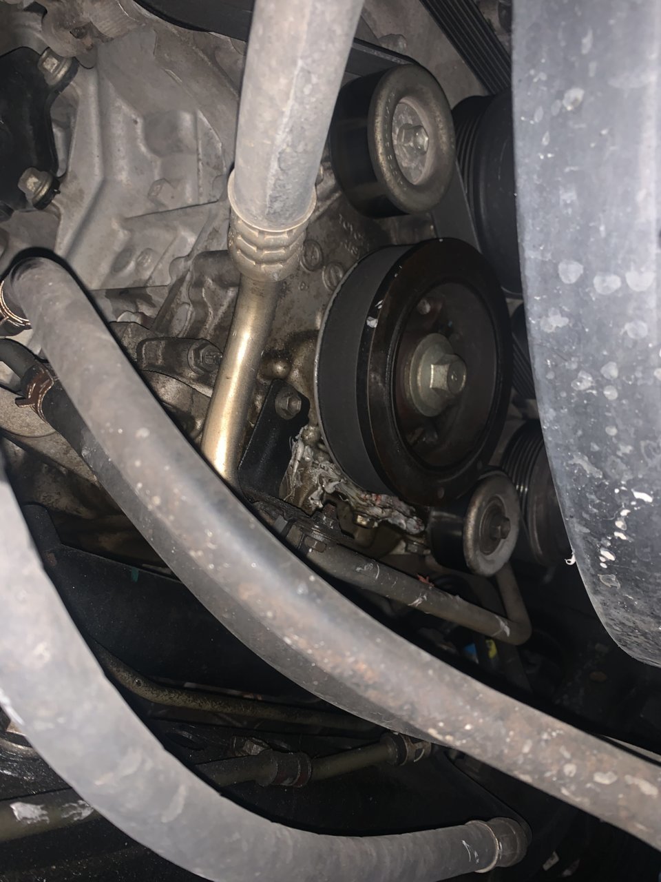

    I’ve read a lot of post about this before making my own and most say their timing chain cover seeps (like mine) but oil doesn’t make it to the ground. Mine doesn’t look that bad up front but when I crawled under the truck last night I find that under the PS pump oil is dripping. Has anyone ever had it this bad?

    Is it dirty oil (Engine oil)? My oil pressure transducer was leaking at one point and it leaked all down the front of the engine and all over the serpentine belt. Was as simple as replacing the sensor which is right near the inlet on the oil filter.

    Try cleaning it thoroughly with engine degreaser or similar then watch to see the source of the leak.

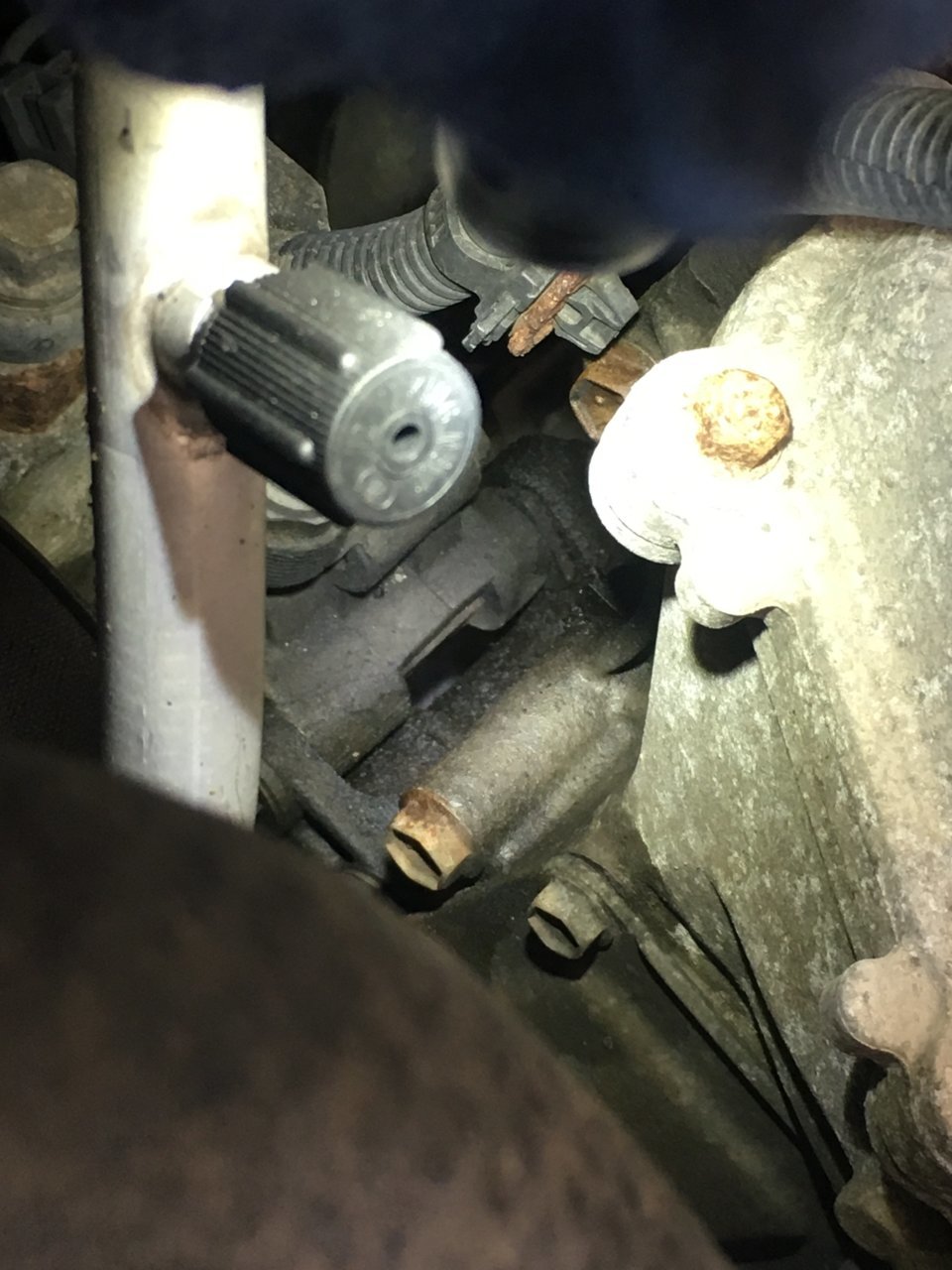

    Kind of its coming from somewhere above the power steering pump or behind it or something its hard to see

    There is a timing cover leak thread. Covers a few different methods to correct the leak.

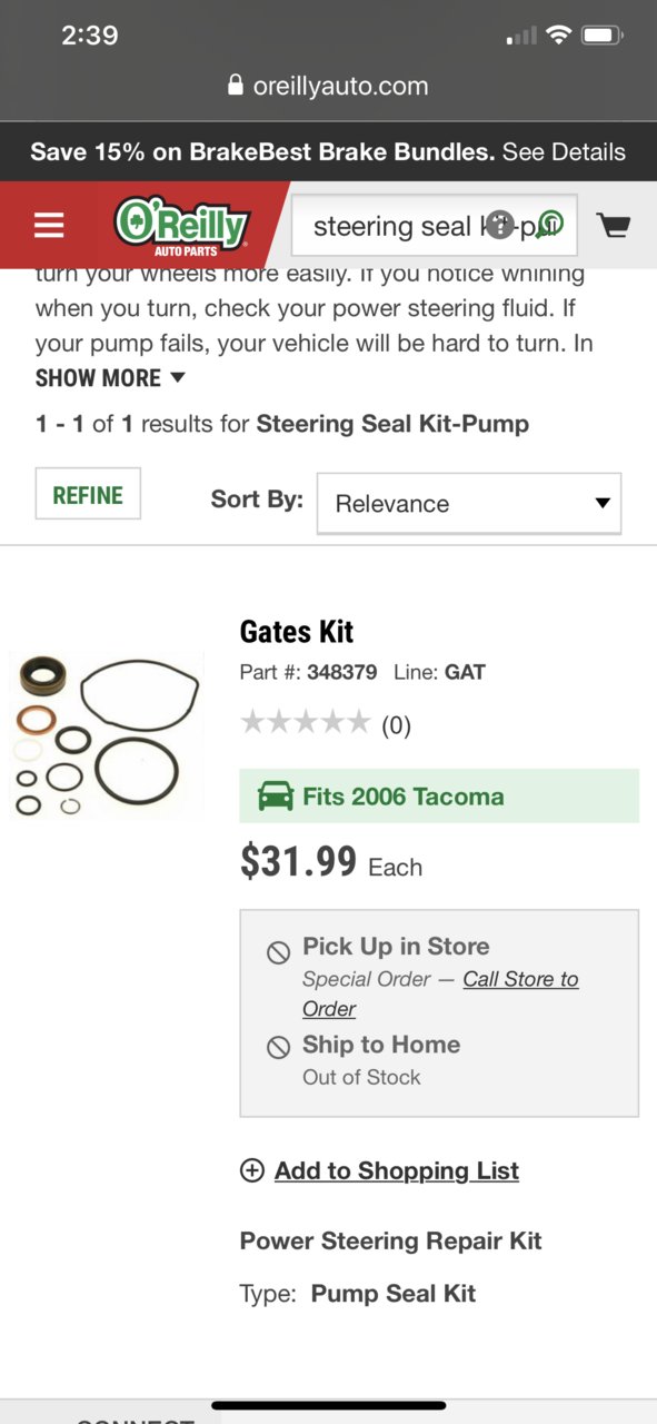

    @Zersko, I had exactly the same issue like yours with my 06 Tacoma. The culprit was my PS pump. I rebuilt it myself, just a bunch of gaskets and O rings to replace. I used this kit (see photo) as it is readily available, and that was around 150K miles ago. Until now, no leaks. Hope this helps.

    No, it only leaked around the PS pump...maybe I caught it early.? Rebuilding the PS is doable and fairly easy. Nothing beats the OEM PS pump that came with your Tacoma.
