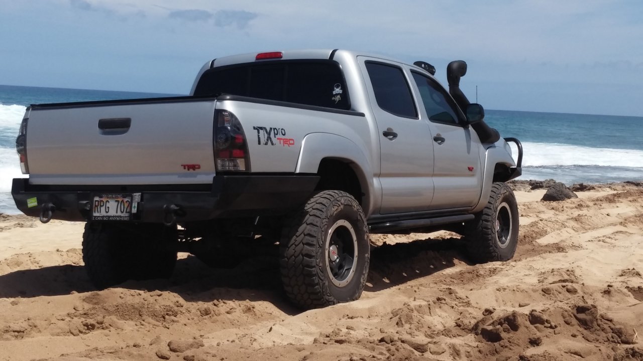

    11 DC 4X4 TX PRO silver
    Trd, Cal Tech, Weather tech, Viper, Al's tinting . L.E.D's , Hide a Hitch or Chrome Stinger , Walker Evans Resi's w/AllPro 3" lift ,FLM, ProComp Xtreme MT2 , Diff Breather Mod, 4x4 Switch Light mod, Plastic Derped. Trailer Socket Relocate mod via Miles , 4:56 G2 gears. Blue Intake Spacer, S.S. Brake Lines F&R, Sway Bar Deleted, Roll-X, Pop-N-Lock Electric. Red metal TRD badges. Paid Off Mod- Chee Hu, Superbumbs(f),Timbrens(r).Pelfrey Bilt, Bamf, Urd. Cobra Heat Shield.CMC .Mishimoto (custom bracket by Nate), Powerstop, Rampage 50".Depo Taillights,SPPC Black Headlights, Rigid Industries. Factor 55.American AirFlow.
    From my experience with a mid travel suspension, 33's and an auto trans , 4:56 gears are perfect. Without the gears, the truck would be reluctant to up shift. The engine would never peak then change gears. With all the added weight I have now the truck feels good driving around and going up or down muddy hills the lower gearing keeps you in better control.20170323_122239.jpg
