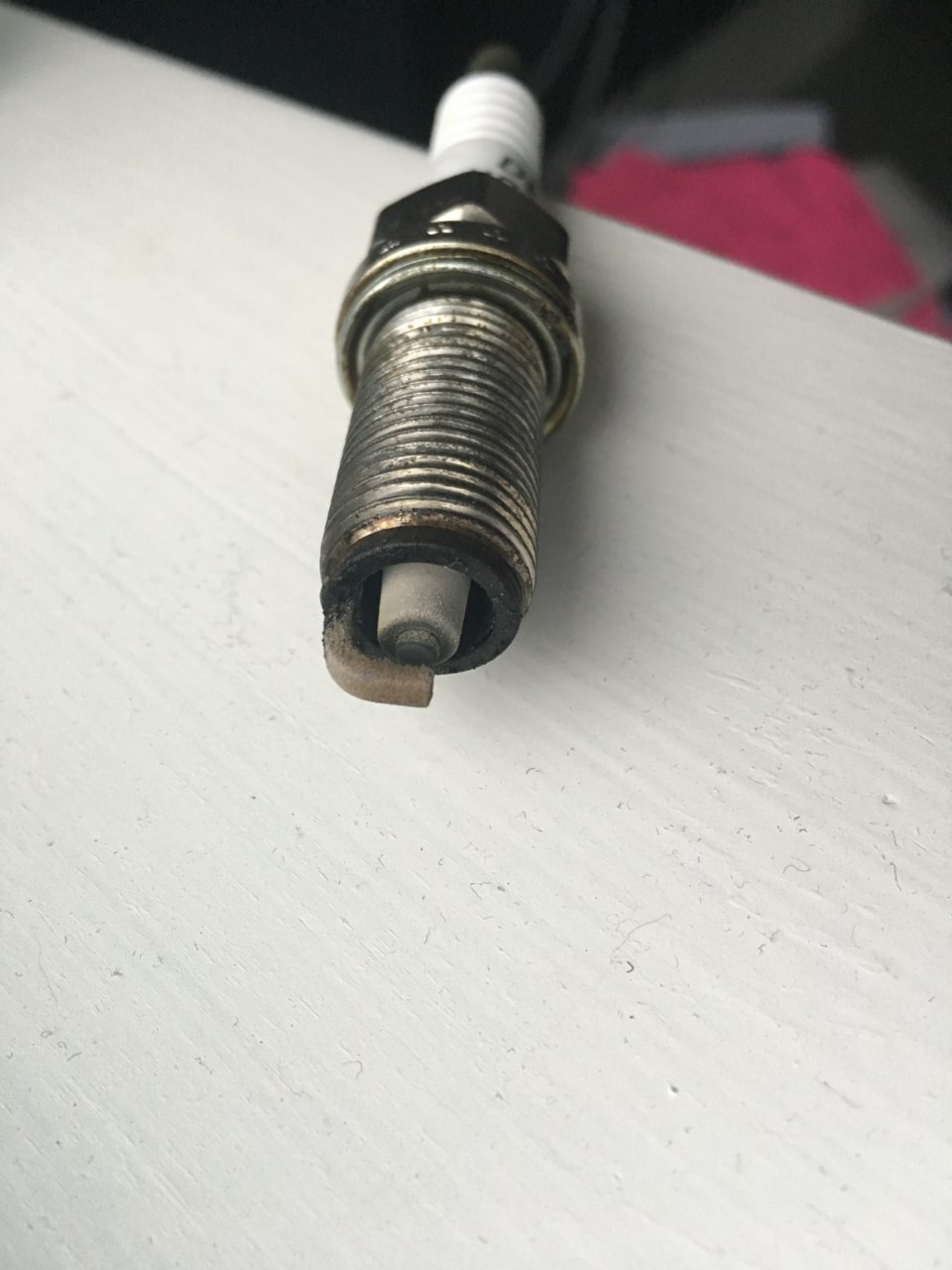

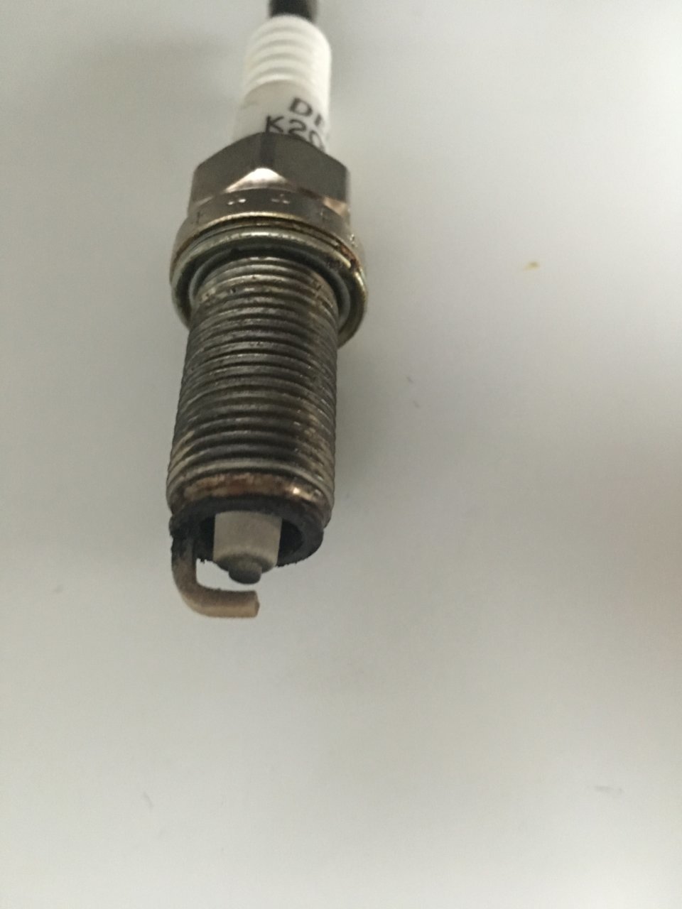

    Hey guys I just changed my copper plugs / 4.0 6cyl. Plugs had about 34k miles. From the pics they're on the worn side gap wise and needed it. Working on the drivers side is always a little like getting a "ship in a bottle" workout but the passenger side is a piece of cake.
    They seem to look normal (all plugs look like the one in the pic) and maybe on the rich side. This could be do to the bigger gap though...or is there potentially something else going on..coolant? The reason I ask is that over the last 68k miles I have to occasionally add coolant to the reservoir - I've added exactly 2.5 quarts over 68k miles / since April of 2016 (3 years). Is this normal? Slow leak or typical loss-evaporation? Truck is a 2008 Prerunner Access Cab with 199,500 k miles and running well.
    I've been using 89 octane with an occasional premium 91/92. Perhaps I should switch back to regular 87. I don't really notice a difference in gas mileage. In the summer I get occasional detonation under load with 87. That's why I use 89 or higher. Thoughts?

    The plugs look normal. As far as the coolant loss, that is more than my truck uses and I live in AZ. It doesn't sound outrageous though. At that mileage it could be something as simple as needing a new radiator cap.

    Those plugs are fine, could have gone another 25K easy.
    Also, stop wasting your money on 89, feed the truck 87.

    Thanks for the advise Mike @ octane - will do. I disagree about the plugs though. The gap was way over spec and if I'm going in to re-gap I'd just assume replace the plugs and save the labor time. My time is worth more than the cost of new plugs, but I get your point.

    plugs look fine, good choice to just replace em.
    As far as coolant, its not excessive, i know my truck will have evaporative loss out of the overflow tank here n there. But 08's didnt have any issues with headgaskets so you are probably good, worst case its a waterpump seal or leaky hose, all which will give you plenty of warning.

    I would think that a head gasket leak would just get worse over time. Perhaps a combo of water pump seal and evaporative. Either way minor issue. Thanks!

    Nah all good. Can't hurt changing em!
