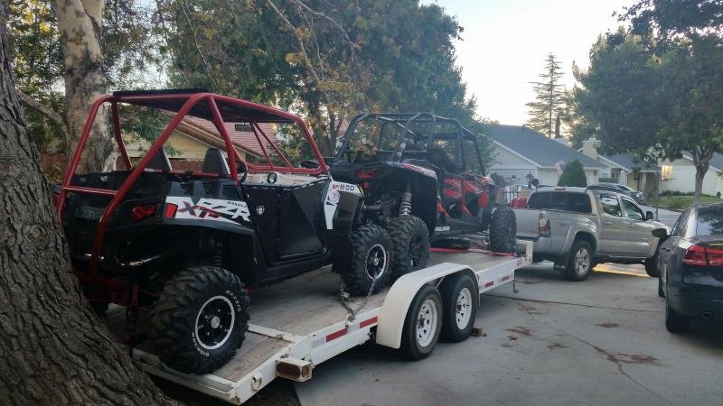

    My Tacoma does pretty well towing. I regularly tow this setup up the grapevine (here in Southern California) without issue:
