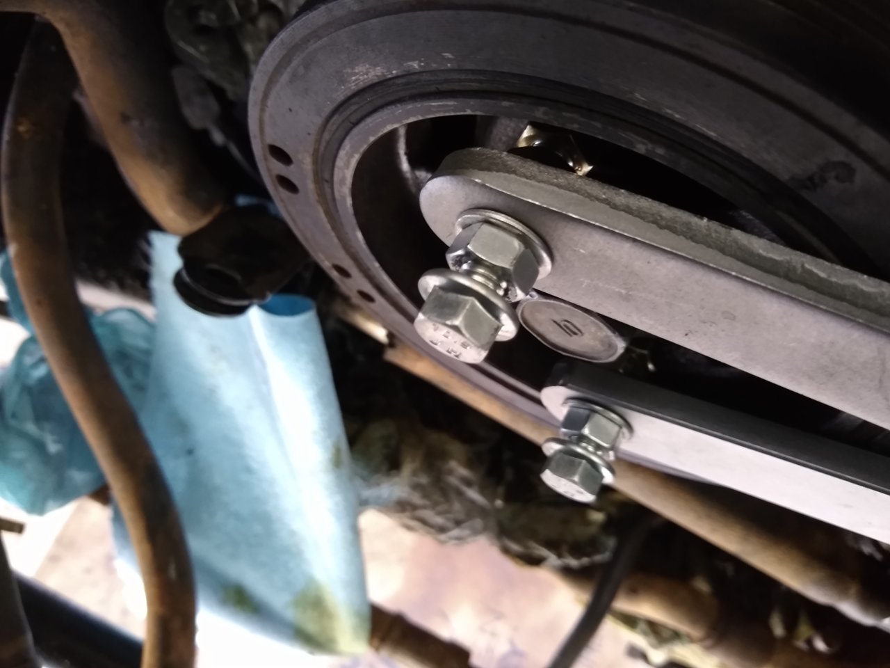

    Adding to OP post, in order not to initiate a new thread.
    Tool posted by OP for taking harmonic balancer out.IMG_20190920_141843838.jpg
    I used 2 M8-1.25X50 with 4 nuts each one. I used 2 nuts locked for limiting the deep you can go in, the other 2 for tightening tool bars parallel to pulley.

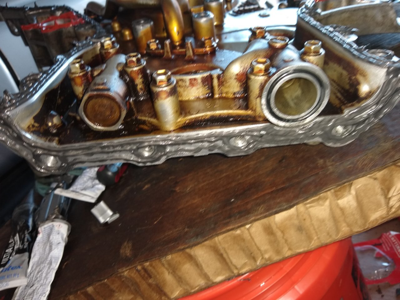

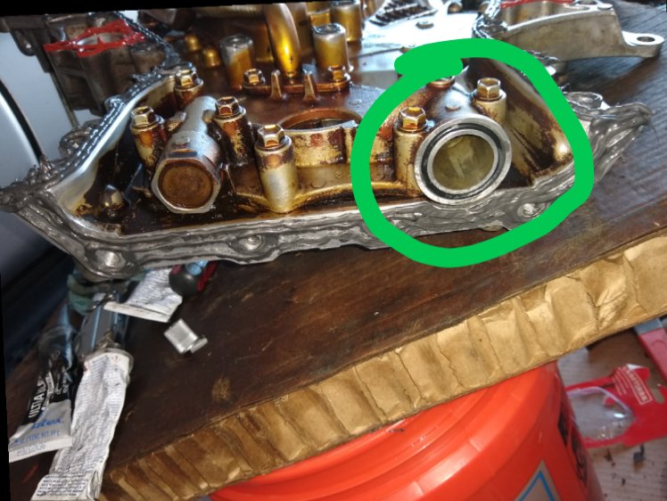

    Then siliconed everything as per Toyota Manual.
    Permatex ultra black for the oil part
    Permatex High temp RTV gasket maker for coolant holes.
    Before siliconing everything, I tried out 3 times putting the cover in and out to be sure oil pump and shaft were aligned and cover went in easy after siliconing.
    Be sure to change this two o-rings
    Press in and tighten bolts by hand, wait 1 hour before final torque.
    Check inside for a nice distribution os new silicon gasket.
