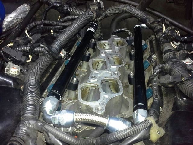

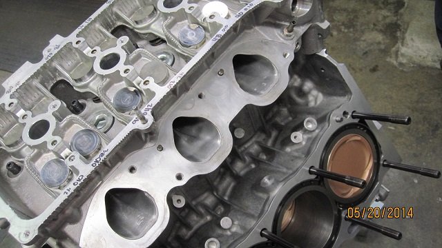

    If the words don't get you satisfied, OP, look at the pictures or schematics.

    Injectors into lower intake plenum.
    Lower intake plenum bolts onto the heads.
