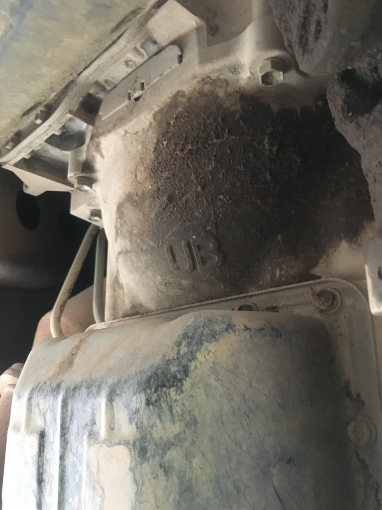

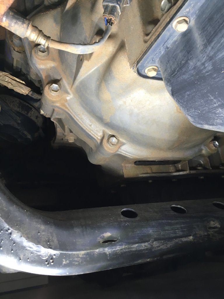

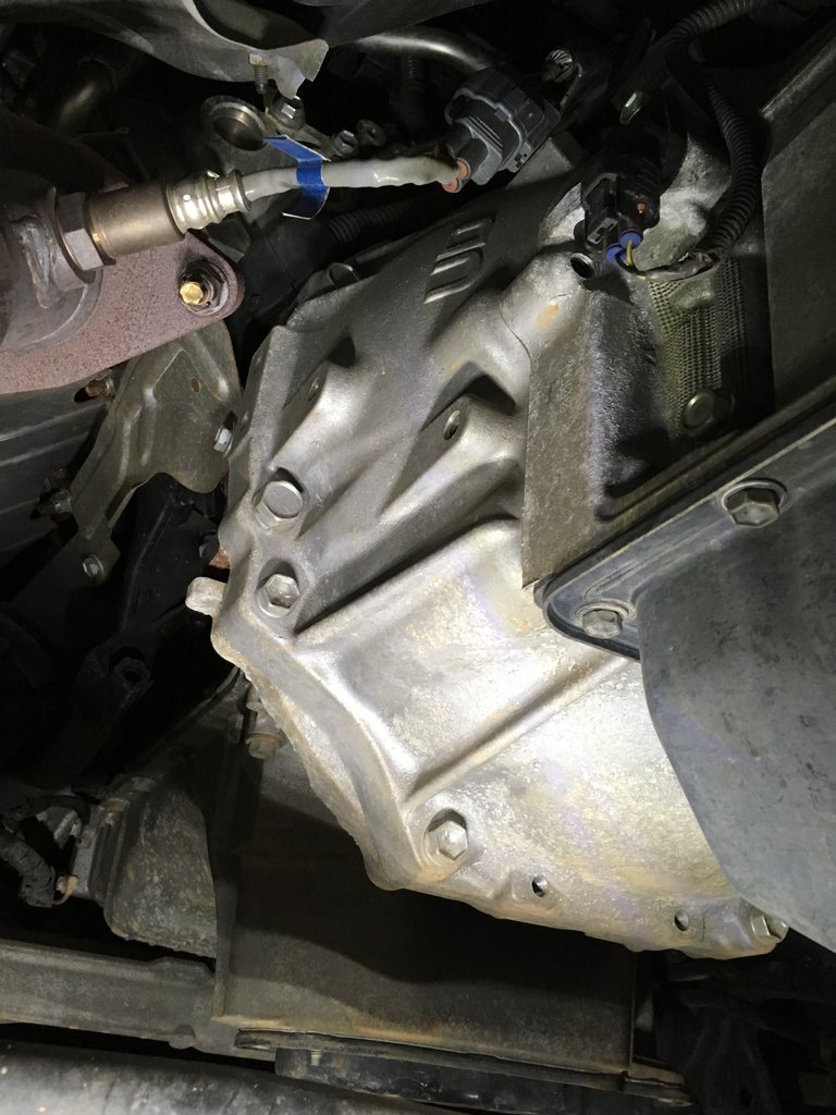

    Awesome! Thank you so much! What year is your 4.7?
    Can you do me another favor and take some more pics and measure the length of both bellhousings?
    I'm buying an 05 Tacoma with a blown engine for super cheap and it just got a new frame. I want to put in the 4.7 but hope to keep the A750F that's already in there and just get IPT to overhaul the valve body. Guess I'll need the bellhousing and TC also from the donor 4Runner also

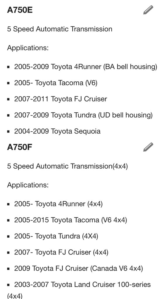

    What's up with the BA and UD bellhousing? Not sure what that means but I know that both those applications where it says that are the 4.7 V8

    I'm not sure where each casting belongs, but it's stamped into the bell housing and easy to identify.

    Tundra is an 09, and Taco is an 07.
    Tundra 5-1/2"
    Taco 5-7/8"
