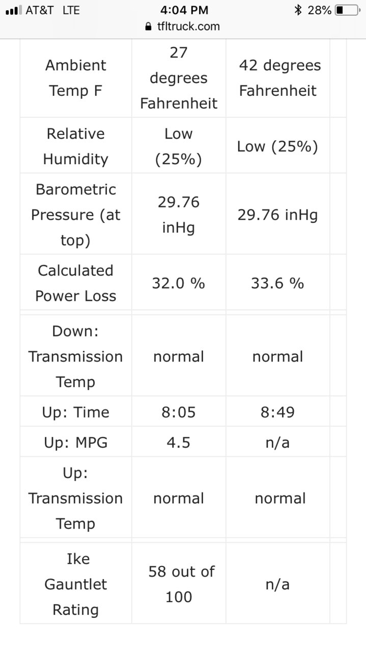

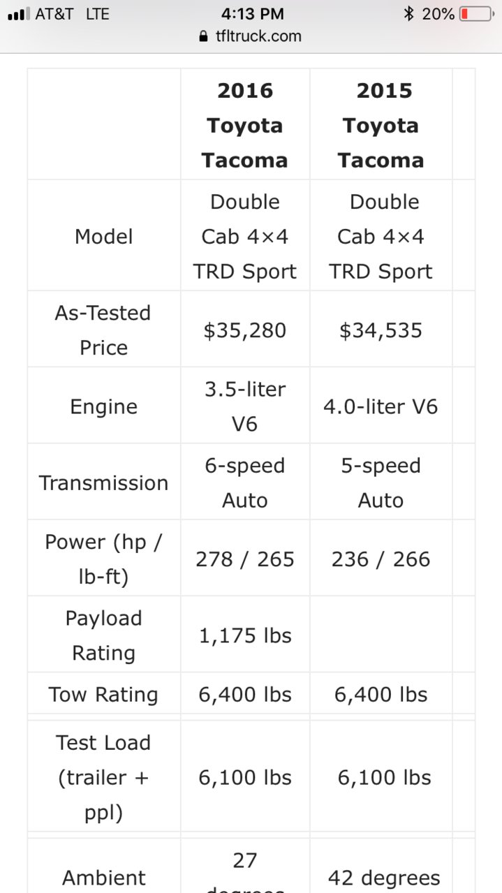

    On the one hand, the 3.5l v6 is a faster (and more powerful) engine (if you rev it up) and can get slightly better mpg's (though the auto's shifting strategies have a lot to do with that). It certainly isn’t a bad engine, as it has seen use across a wide variety of applications. It’s direct + port injection and part-time use of the Atkinson cycle also demonstrates innovation on Toyota’s part (I’m not aware of any other OEM’s putting that kind of engine into a truck). The engine response (and low-end torque) is acceptable if you get the manual with the 4.30 gearing. It’s no torque monster, so its unsuited to heavy towing or hauling, but then again the Tacoma’s overall GVWR doesn’t lend itself to such duties either. It offers very good horsepower delivery once you get high into the RPM band and wring it out (though some would argue that is the opposite of what you want in a truck engine). I see the engine working well for someone who wants a truck he/she can daily drive to work and go have fun on the weekends.
    On the other hand, the 3.5l v6 is most definitely derived from a car-focused design (where top-end power is prioritized over low-end torque), whereas the 4.0l v6 was designed/built from the ground-up as a truck engine. The 4.0l isn’t anything special by comparison, but it does have somewhat better low-end torque, which is more relevant for 4x4 and truck applications. The 3.5l, even with the manual, just feels a bit more gutless at the low to mid range of RPM’s, which is a range everyone has to drive through at some point as they accelerate, tow, go uphill, ect. The 4.0l provides a bit more grunt in that low to mid range of the RPM band, even if it is a bit out of breath on the top end. Toyota obviously acknowledges the truck heritage of its 4.0l v6; they use that engine, not the new 3.5l v6, as gasoline alternatives to their diesels in overseas platforms (hilux, prado)….though diesel powerplants are far more preferred for trucks in pretty much every region outside of North America.
    Having driven both engines back-to-back, I definitely prefer the 4.0l v6 even though it is a bit less efficient. However, if I was going to get a new midsized truck, I would pick the Tacoma hands-down over anything else on the market (including the new Jeep and Ranger). I like the diesel powerplant of the Colorado, but I don’t trust the overall platform it’s been put in. The Tacoma, for all its faults, is a proven platform and arguably a bit overbuilt compared to just about everything else in the segment.
    And for all the people pointing to TFL’s Ike Gauntlet tow trials as proof that the new 3.5l v6 is “better” than the 4.0lv6, or even the 2.8l Duramax, I question how much towing experience you really have. The 3.5l is a more powerful engine compared to the latter 2, especially on the top-end, so of course its going to be faster going uphill, or in general. However, speed is only a small part of the towing equation. NVH, engine response, fuel consumption all factor into a buying decision for people who tow on a regular basis. The 3.5l ecoboost F-150 can tow 5klbs faster up a hill than a 6.7l Cummins or 6.7l Powerstroke; the latter 2 diesel engines are still widely preferred (for dedicated towing) over the ecoboost because they offer better low-end grunt, better fuel consumption and are less stressed out in such applications. The 3.5l v6 Tacoma might tow faster, but its working hard and screaming loud as hell when doing so (arguably losing all of its efficiency advantage at that RPM range)….ultimately there are better tow engines out there, even in the midsized segment.

    I own a 2nd gen, so I have no first-hand knowledge of the 3.5l. I will say the 3rd gen engine choice was a disappointment to me and why I bought a 2015 vs a 2016. Not knocking the 3.5l, I was just expecting something more after waiting 10 years for an update. The power output, mpg, and towing differences are negligible. With modern technology and advancements made in the past 10 years, the hp should be closer to 300 and mpg should be closer to 25 (for a midsize,ccsb 4x4, v6 truck)

    They did the test with a 2019 in their Ranger comparison video and it seemed to do better than the 2016 original test. Would have liked to see numbers on that. ECU updates since 2016 have made a pretty significant difference in driving experience, wonder how / if they make a difference in towing...
