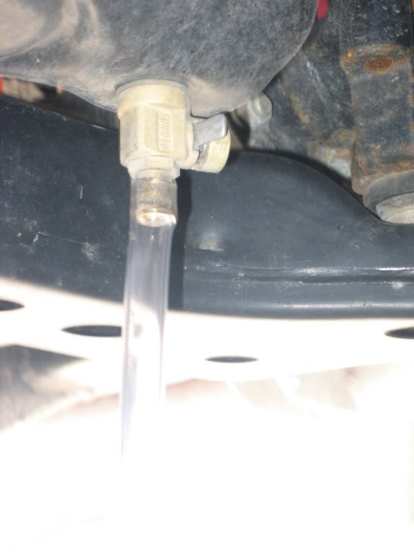

    I guess I never thought of any other DIY task clear tubes would be used for, that's why these shops never entered my mind. I was thinking Hobby Lobby type places LOL

    I use an empty Aquifina water bottle (though any brand will work). Plenty of them laying around and then you can just put the lid on and toss in the garbage.
    The bottle rests on the components below and stays put while the collar drains.
    I also have a Fumoto and highly recommend them. Very good quality and very easy oil changes. My only complaint is how long it takes the oil to drain out of it when using a tube. I usually start the oil draining first, then work on replacing the oil filter. Then check the tire pressure (fill if necessary). Then change the air filter. Usually by then, it's drained all of the oil out. If not, grab a beer and wait.

    Just finished my first ever oil change. I got the 15qt oil pan from Walmart with the funnel for easy disposal and everything.
    Holy crap, I may as well NOT have that thing. The oil came out SO DAMN fast half of my 5.5qts ended up splattering on my driveway. wtf ..
    It took longer to clean up that mess than change the oil.

    I changed my oil in the new Tacoma the other day for the 1st time @ 1297 miles...I went with Mobile-1 5w-30 and a YZZD3 filter.
    I had to use a strap type filter wrench to remove the factory filter...the end cap wrench w/ ratchet couldn't break her loose. No biggie.
    I found that the 5/16" hose from the filter "catch" to the oil pan, was more trouble than it's worth. Next time I'll go with the empty water bottle method.
    The oil pan bolt and crush washer was a piece-of cake.
    Even though I get service w/ the new truck for 25K miles or 2 years...I will do my own oil changes. I enjoy it...and I know it's done right the 1st time.
