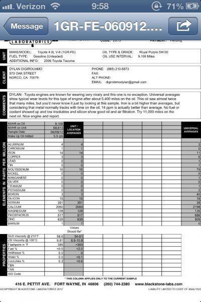

    Went almost 10k between changes accidently. Decided to get it tested.

    Damn, that report looks impressive. Looks like there was practically no difference between 10k and 5k miles! Food for thought I guess....were you using synthetic or conventional? How many miles on the motor?
