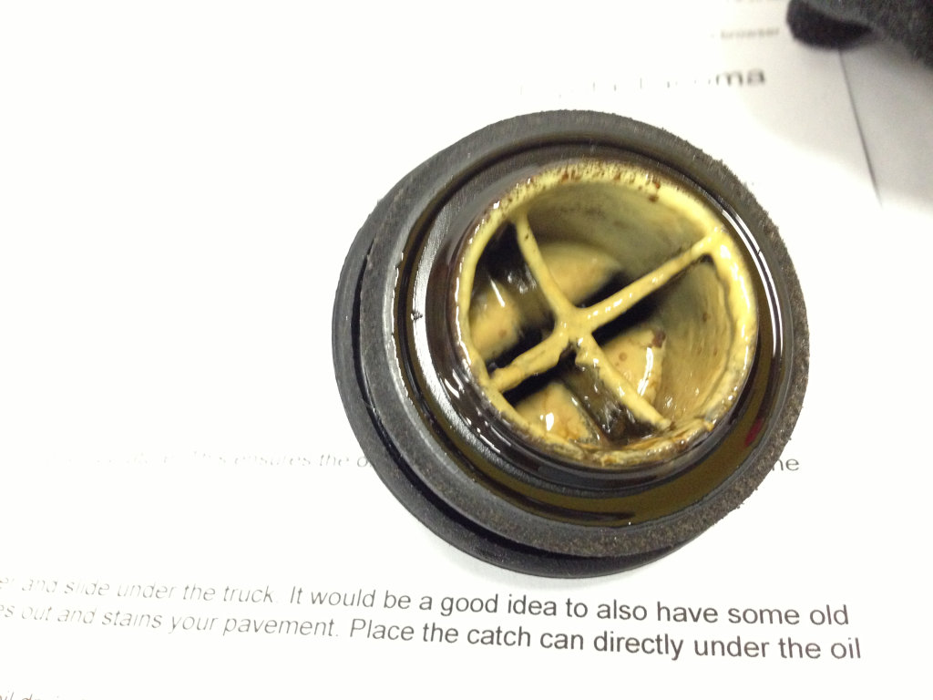

    I wouldn't worry about it either, some new Tacoma's coming in for their first oil change have condensation on the oil cap.
