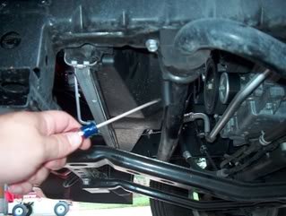

    the first oil filter that comes from the factory is a bit tough to take off.
    some people stick a screw driver through it and it helps to twist it off

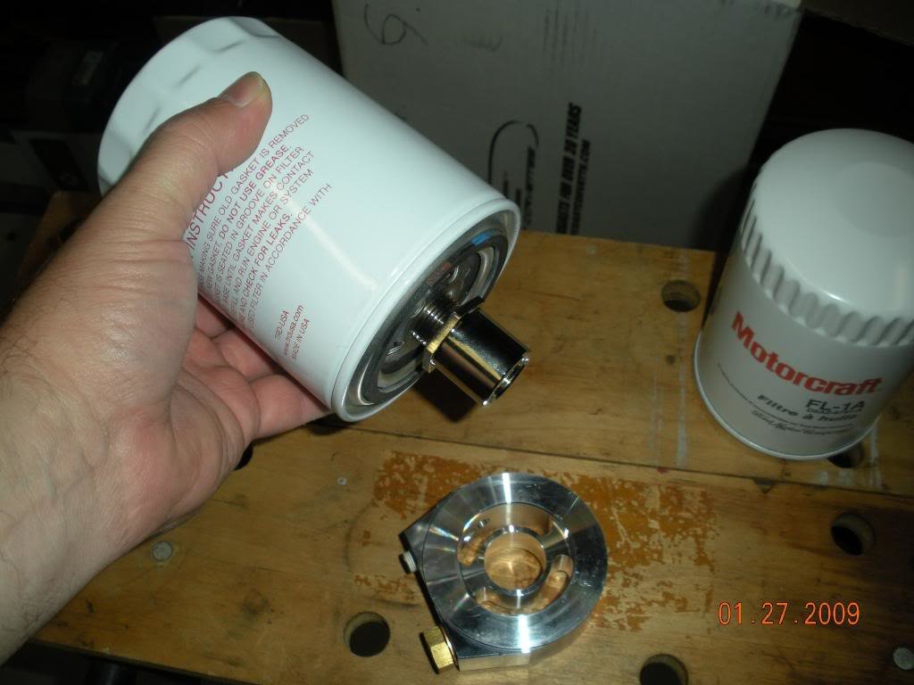

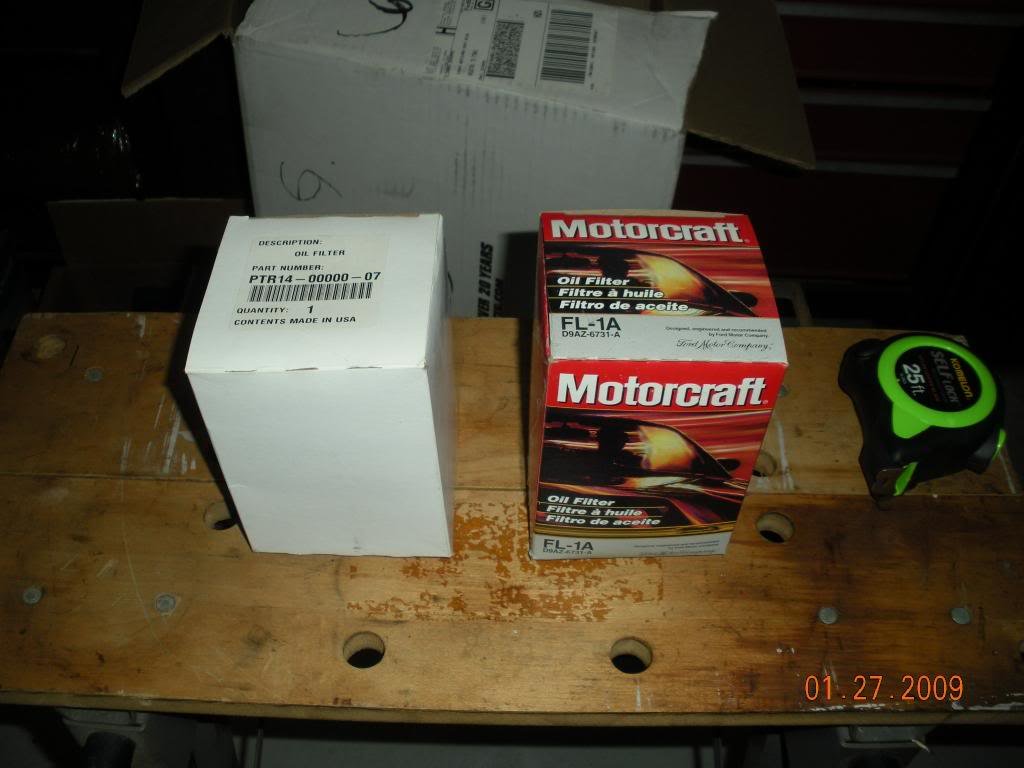

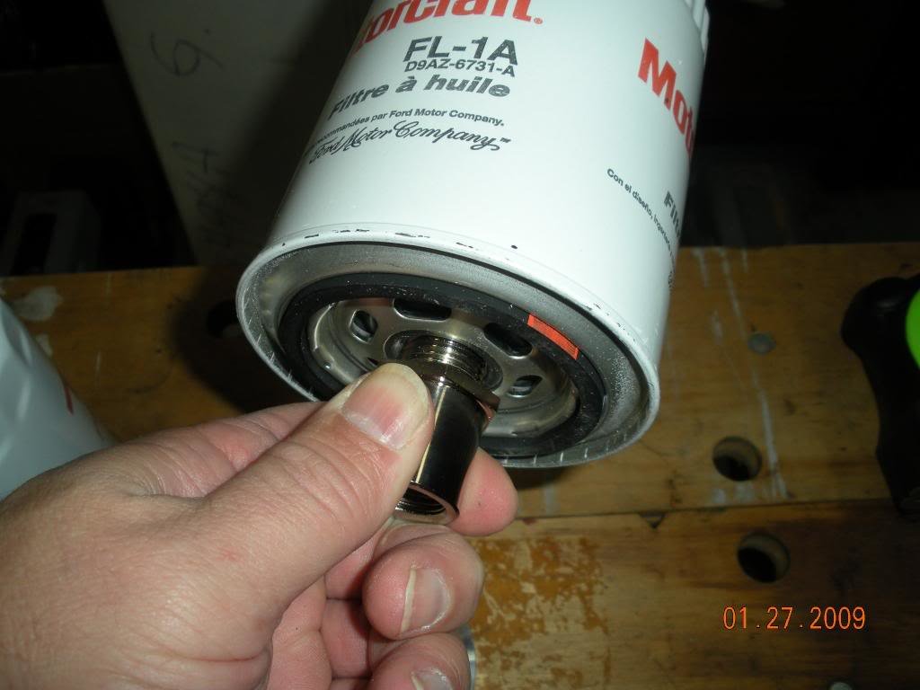

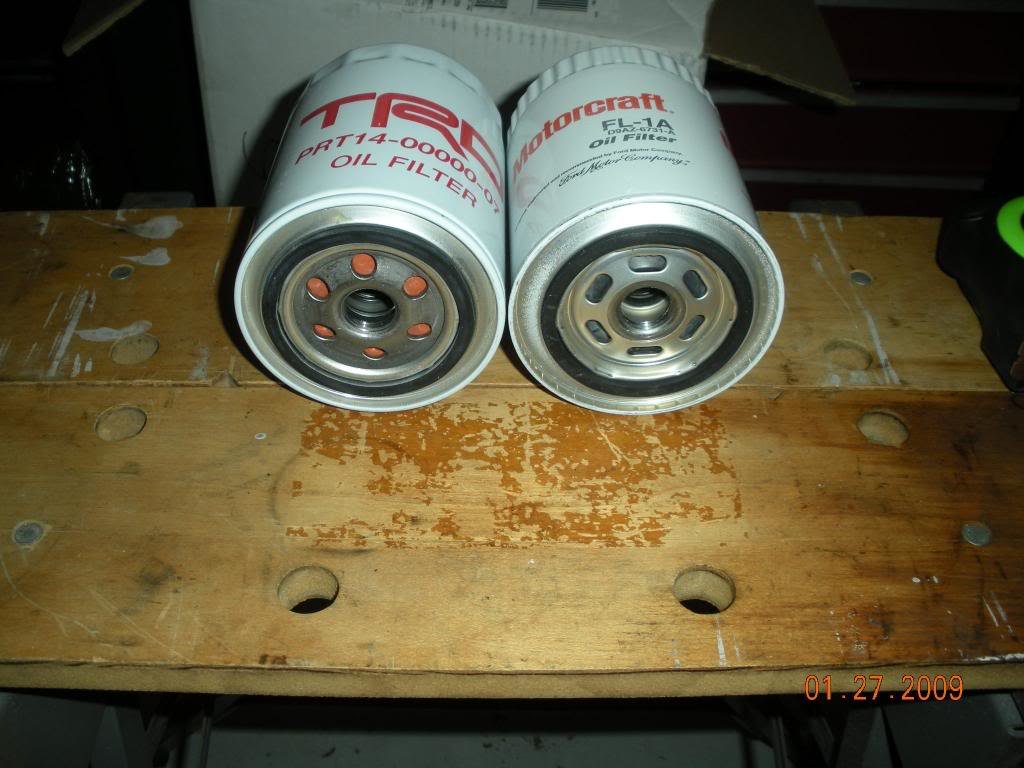

    I have Fords as well as Toyota. I thought this was interesting if you want to use a large filter.
    The Filter on the left is a TRD filter, supposedly discontinued. The filter on the right is a Motorcraft FL1A (most V-8 Fords use this filter).
    trdfilter003_42201de0cea8548c6043fe33f812ff1386b96b7c.jpgtrdfilter008_b2941d52f2cafee8d46276b48cf4d4387c1c8922.jpg
    Wessty likes this.

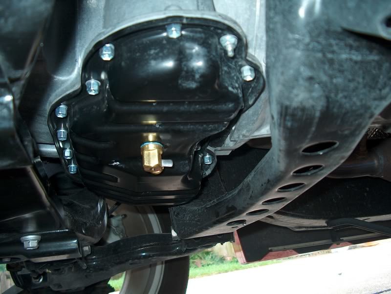

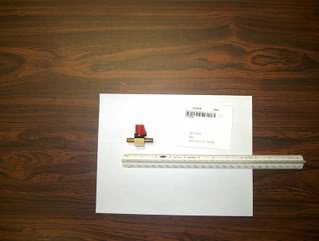

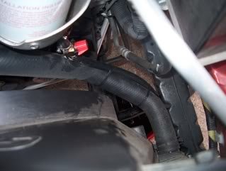

    This is a simple mod I did a while make for the oil filter drain cup. I added a small petcock like would be on a motorcycle and a small vacuum line. Then I can easily control the drain of the oil filter cup.
    fökai671 likes this.

    Excellent idea. I'll send pics after I install my Fumoto.

    Like this.

    Well Okleedoklee then! 4 cyl or V6? Can't tell.....

    Except mine has the nipple hose attachment and a plastic cover to keep debris out of the valve mechanism. Harrumph!

    V6, X runner
