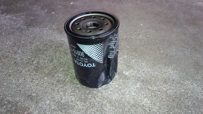

    I ended up purchasing a Synthetic (Penzoil Ultra Platinum) @ 5W-30.
    Had adventures with both swapping out the oil filter (my filter wrench was useless -- Ended up having to drive a screwdriver through the middle and corkscrewing off) and draining the oil (NIAGARA FALLS).
    I'm letting the oil drip-drain overnight. My followup questions are: Should I be looking for anything in the old oil for signs of good/bad? What is this magnet/shavings check I keep hearing about? This is the first oil change on the vehicle (4,575 miles on it). Anything else aside from the tutorial on Page 1 of this thread I should consider for a first oil change? Thanks.

    Drip-draining overnight is a little extreme, but to each his own.:p
    I don't know if the oil drain plug is magnetic, I don't think it is. The diff drain plugs are, but that is completely different.
    As long as you are changing the oil and filter on the 5K schedule, there's not a lot you need to check regarding the oil. Maybe just noticing anything that stands out as different from normal like a burnt smell, things like that.

    Just smells like oil to me. When it was pouring out it looked black but when looking at a single drop it's amber/transparent. I assume that's how it's supposed to be. Thanks for the feedback.

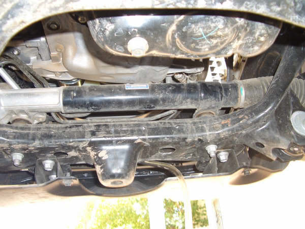

    OK, after 8 years of ownership I've decided to start changing my own oil. I can't figure out where the oil pan is as I have an All Pro skid plate blocking my view (I think). So... is the oil pan on the drivers side or passengers side of the truck? I'm sure people have not been removing the skid plate to change my oil, so any tips on accessing the bolt?
    Thanks!

    It's the one closest to the front of your truck. I think it's right in the middle, but it might be a tad closer to one side. Grab a flashlight and scope it out. I was nervous the first time after reading how many people make the mistake of grabbing the transmission bolt, but once you are under there, it makes sense.

    So then, the skid plate is in the way...
    Anyone ever change the oil w/o removing the skid plate? Is that doable?

    Thanks. Just purchased the valve with the nipple, the 3' hose and the new lever lock.
    I got on my crawler in my work clothes last night in a dark garage and rolled around under the truck. I didn't see the oil pan which is why I asked. My truck has 68k miles on it and most of the oil changes have been at a local Toyota dealership that takes 90 minutes to change the oil. Maybe (hopefully) that's why...
    Either way, I've decided to switch to full synthetic and will change it myself once the valve arrives.
    I'd still be interested to see what others with an off-road skid plate say about changing the oil with the skid plate in the way. Is the valve the only way around changing the oil w/o removing the skid plate?
