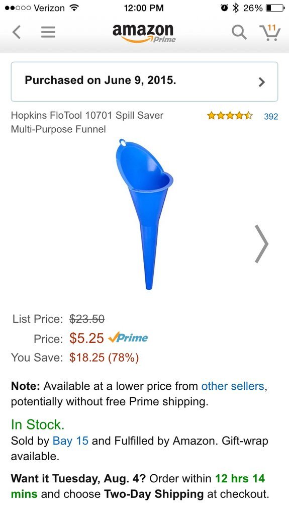

    another funnel - $4.37 wally world funnel - funnel threads are a perfect fit.
    the black/blue screw on cut-off valve has a wire mesh filter screen fits a mobile1 qt. bottle for a quick top off every few months for the oil burners.

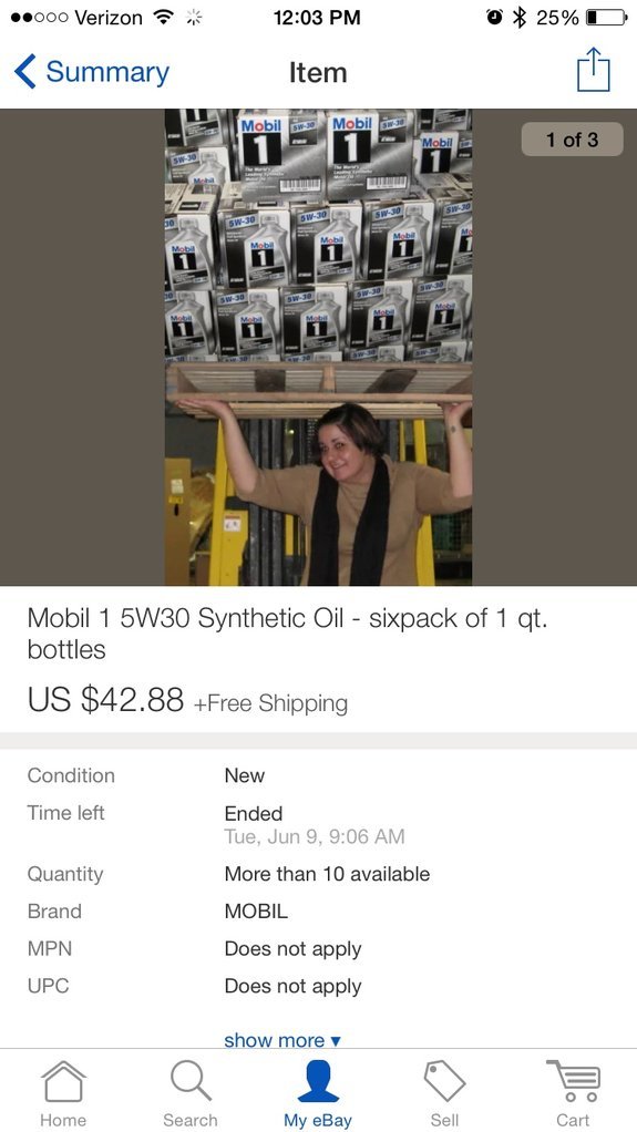

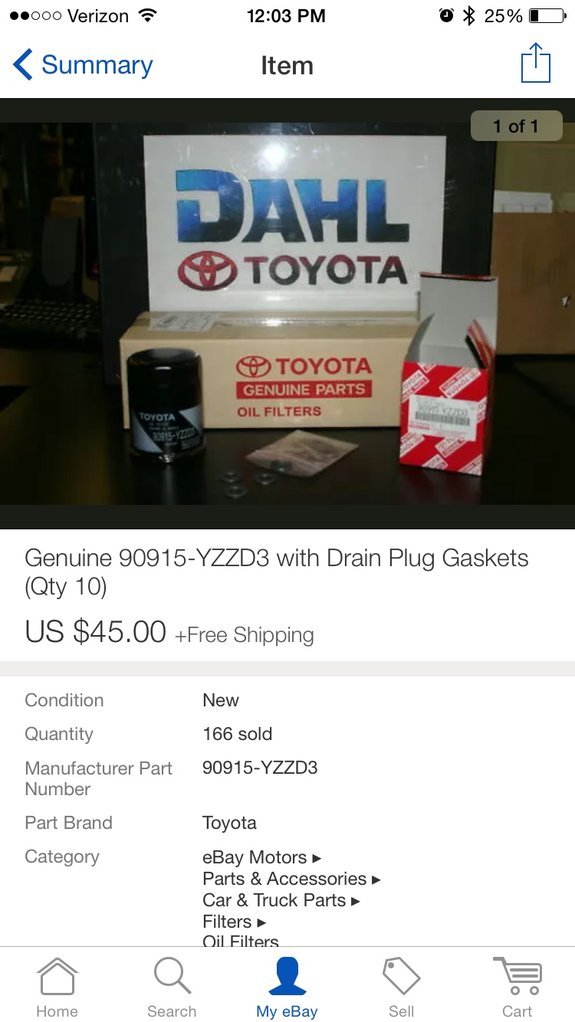

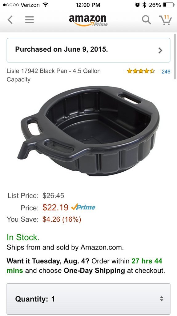

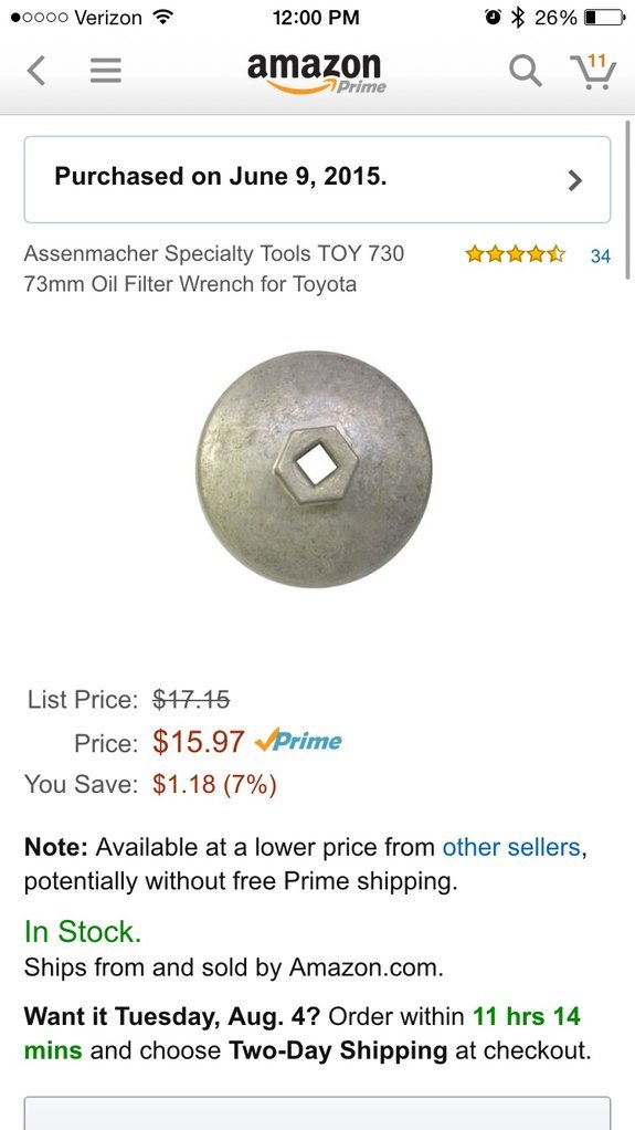

    I purchased everything off Amazon and eBay (pics below) and my process works great
    I'm not saying I'm the quickest but it usually takes me <25 minutes with the following tools
    Also I get my oil and filters online
    The bulk purchases work great for me since my wife has a 4th gen 4Runner that also has the 1GR-FE so I can get everything I need at once
    I've priced it out per oil change and I'm spending $47.38 which I feel like is a great deal considering I'm using Mobil 1 Synthetic and OE Toyota filters

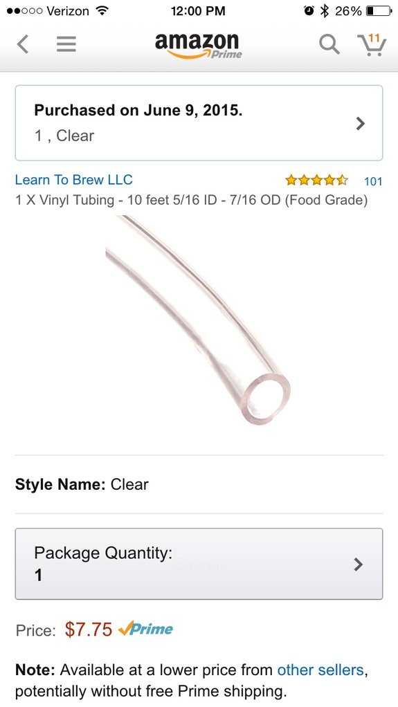

    I've been running a tube down to the drain pan. I'll let it drain and dribble until I'm done with the oil change, then use a rag to wipe out the catch basin and disconnect. If I'm sloppy I might get a drop on the garage floor.
    I have been mulling over replacing the drain plug with the valve (fumoto). No more oil on my socket or hand when I remove the drain plug.

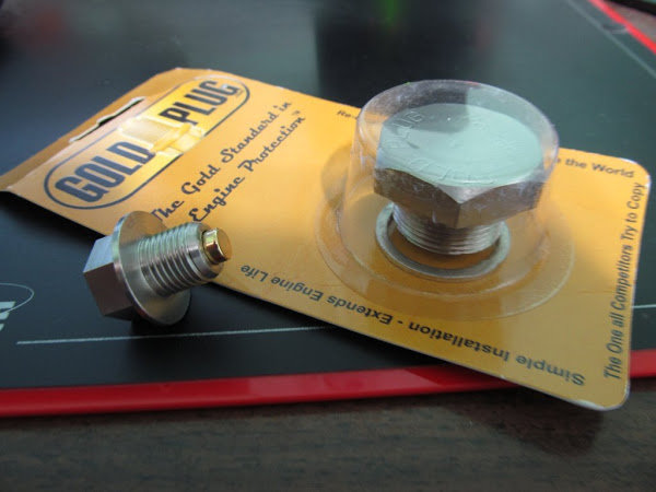

    There's a magnet drain plug available for our trucks, GoldPlug P/N AP03: http://goldplug.com/shop/ap03/ I bought one, shown with larger AP24 for the front diff. Both are stainless steel:
    Changed the oil today and noticed the GoldPlug oil drain plug uses a 15mm socket instead of 14mm stock.

    ^Yep. Expensive. You are paying for machined stainless steel and a pretty strong magnet (stronger than the OEM one on the rear diff).

    Was going to order the fumito valve but was a little worried about leakage/breaking so I ordered the Goldplug. It looks like it has a permanent washer and not a crush washer.

    The GoldPlug comes with an aluminum washer, similar to OEM but without the felt lining. It is not meant to be reusable.
