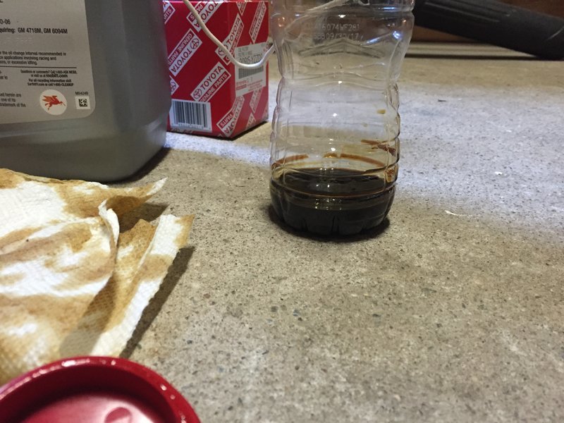

    Just thought i post this for the hell of it. I drained the oil and put a hole in the filter and waited about 10-15 min's and this is what came out of the filter when i took it off.....Don't need much to catch it!

    No need to cut a hole in the filter.... it all drains down anyway. That's what I get without cutting a hole in the filter

    I saw the "pop a hole" in the filter a few posts back and kinda made sense so i figured i'd try it. I'll do it again next time without the hole and see what i get...
