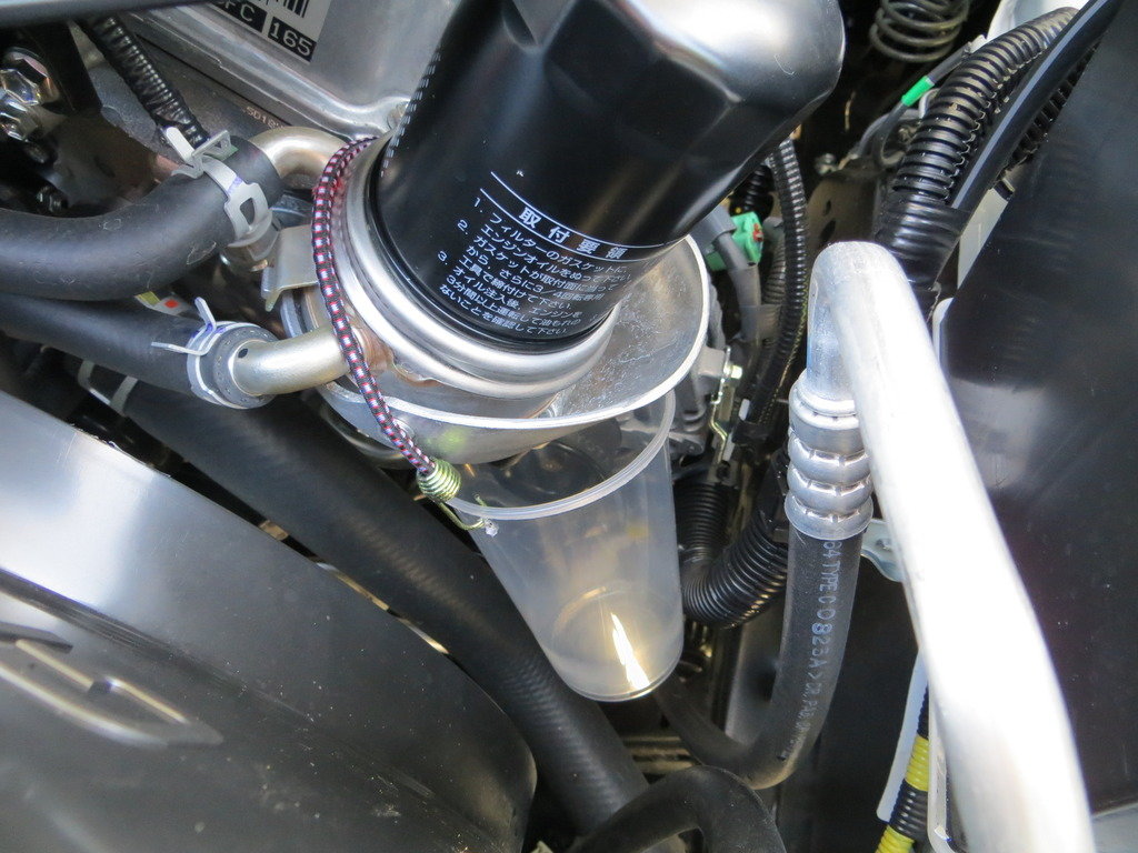

    Just changed my oil before reading about the potential filter reservoir mess...I drained the oil before removing the almost empty filter...one quick wipe in filter reservoir...no plastic tube, no Dixie cup, no mess, no fuss. Anyone see an issue with this approach?

    Well, as long as no mess, then you are good to go! I wasn't fast enough when I changed mine recently(first time for me to do the change), so it was messy down below. Secured the 5/16" 5' tubing for the next time. Also, purchased a 5/16" vacuum cap to replace the missing plug.

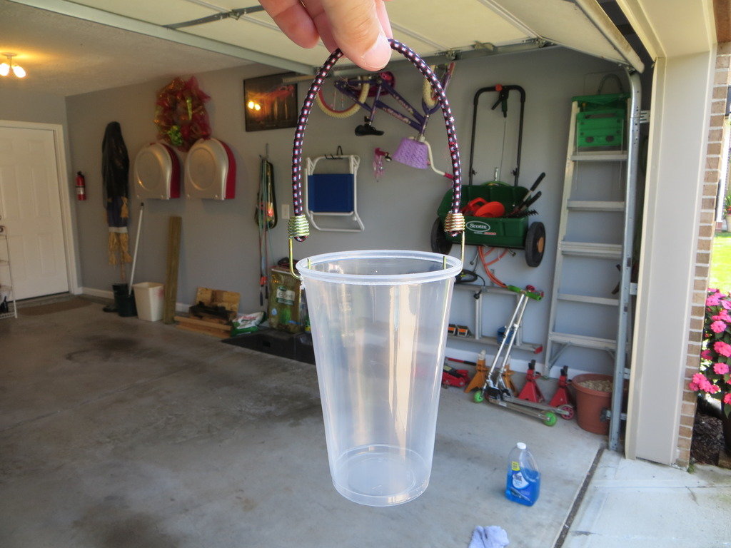

    @plainjanetaco, SMART! I like the cup catch method. I modified it since I didn't have a small bungee cord. I used a cut in half water bottle with 550 cord. @raycie, I did the same thing, the ol' rag method before I saw this post!
