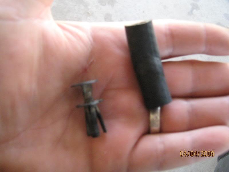

    so i just changed my oil this afternoon. I dropped the oil drain plug some place in the engine bay, so its probably lost forever. I just cut out a piece of the plastic tubing that i got from home depot, covered one end and used that as my plug.
    My question is, will the heat from the engine bay cause that rubber tubing to melt onto the plug? It seems like it gets really warm in that area, but since the plug isnt directly connected tothe motor, it doesnt seem that it will melt the rubber part to the drain plug. So do you guys think i'll be alright with my homemade drain plug or should i take it off.

    You should be able to find the right lug at an auto part store. It should be in the Vaccume tube section. You will be fine. There is nothing near the bottom of the engine that would cause it to melt. It would have to get lodged on the exhaust somehow. In fact, The first time you get past 50 mph, it will probably have blown out. It will be fine.

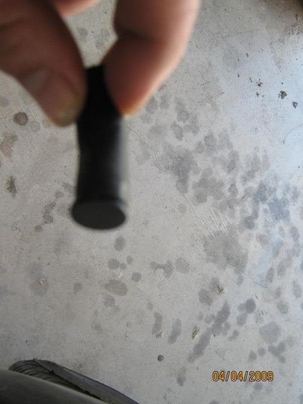

    I changed my oil today for this first time on this truck.

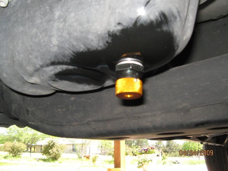

    I bought an EZ Change drain plug from O'Rileys

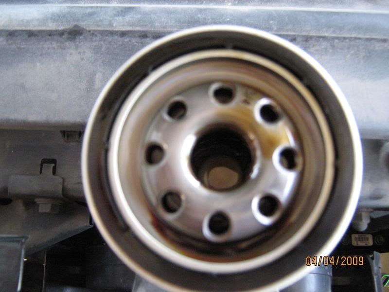

    I was worried about the mess from the oil filter so I opened the filler cap and pulled the dip stick first then I drained the oil. Once it was drained I pulled the filter. No mess at all. The filter was completely drained. Here is a pic of the resivoir when I pulled the filter
    And the filter its self

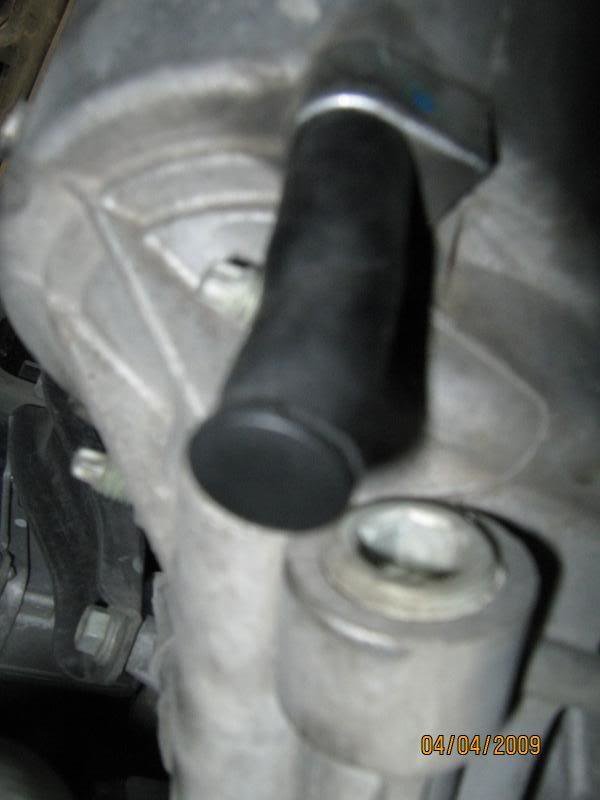

    When I was putting the drain hose on I found out somewhere along the line the cap was never replaced so I made my own. I cut a length of hose and I had an extra clip from pulling my mud flaps and it fit perfect.
    I also made it long enough that it will be easy to pull on the next change.

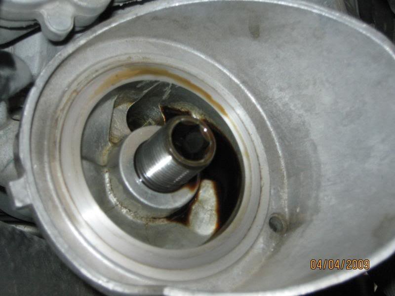

    I finally got my oil filter off after trying unsucessfully "twice" before. I've tried several different tools and nothing has worked. Sunday I said that was it the "pig" was coming off or I'll buy new filter and replace the truck ;).
    I used a filter wrench that fits the bottom and has a 3/8" drive hole, it acually broke it when I applied force...don't know the torque setting they used when they installed it (still new from Sept 08) but this was stupid! And in case anybody asks "were you turning the right direction" or "did you have the right wrench", yes to both! My buddy grabbed a hose clamp and repaired the oil filter wrench but that still didn't help. Next we added some 2 sided tape and emery cloth to the inside of the oil filter wrench and jamed it on...one hard turn did the trick.
    It is finally free and I'll be able to do my regular oil changes from now on. Just thought I share this in case any someone else ever has a similar situation.
