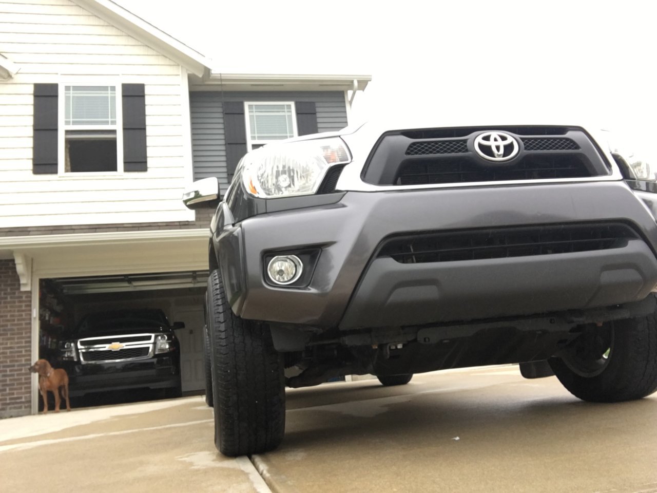

    Finished up my first oil change on the Taco. Dealer I bought it from freeking cranked the oil filter on so hard I had to stab it with a screw driver to get it off....errr (This is why I do my own maintenance, that and it can save you 100’s of thousands of dollars over a lifetime) glad I checked the forum because I had some tubing lying around and hooked it up to drain the filter. Greased my 5 driveshaft point as well. Been using mobile 1 full synthetic for the last 20 years, guess I’ll stick with it until it lets me down.
    God I love my Taco!! All cleaned up too. EE3F89B4-F099-4FF8-8740-DE0FB3C3F714.jpg

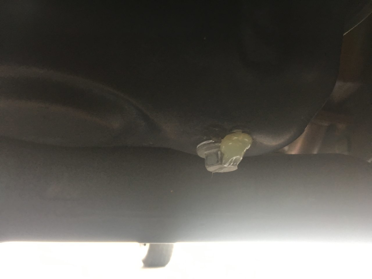

    old post but the dab of silicone actually prevents the bolt from backing out accidentally

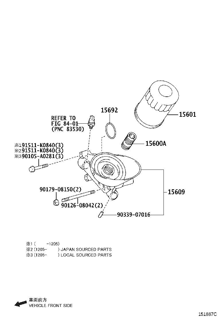

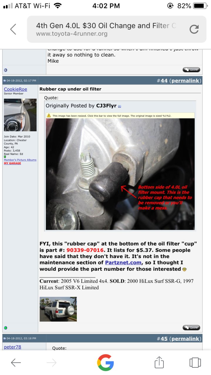

    Bought my Taco used. On my first oil change, I noticed the plastic cover that goes over the drain plug hole next to the oil filter is missing. I know to connect a drain hose or cup when I change the oil, but I am worried my wife or family will "help" me someday and take the Taco to a 10-minute oil change shop and they will remove the oil filter without knowing how to properly protect the engine from oil spill with that drain plug missing. Question-> What is the easiest cheapest replacement for this drain hole cover? It looks like a very cheap plastic cover that only costs .50 cents to make, but I bet the stealership will want $40 for it. Is there any type of DIY plug cover that is easily obtained to replace the OEM oil filter drain hole ?
