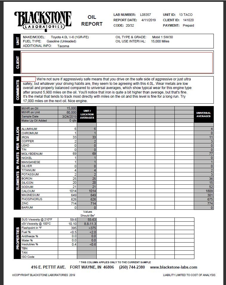

    I go 15,000 miles on mine. I had it tested at my last changed and they suggested going 17,000 miles.
    Mobile 1 15k synthetic and their long life filter

    Similar I typically go 12,500 on whatever synth is on sale and Blackstone suggested 14k last analysis. I want to try Walmart supertech synth next.

    I think I am going to opt for the TBN and TAN test next time, just to see how the additives are holding up.
