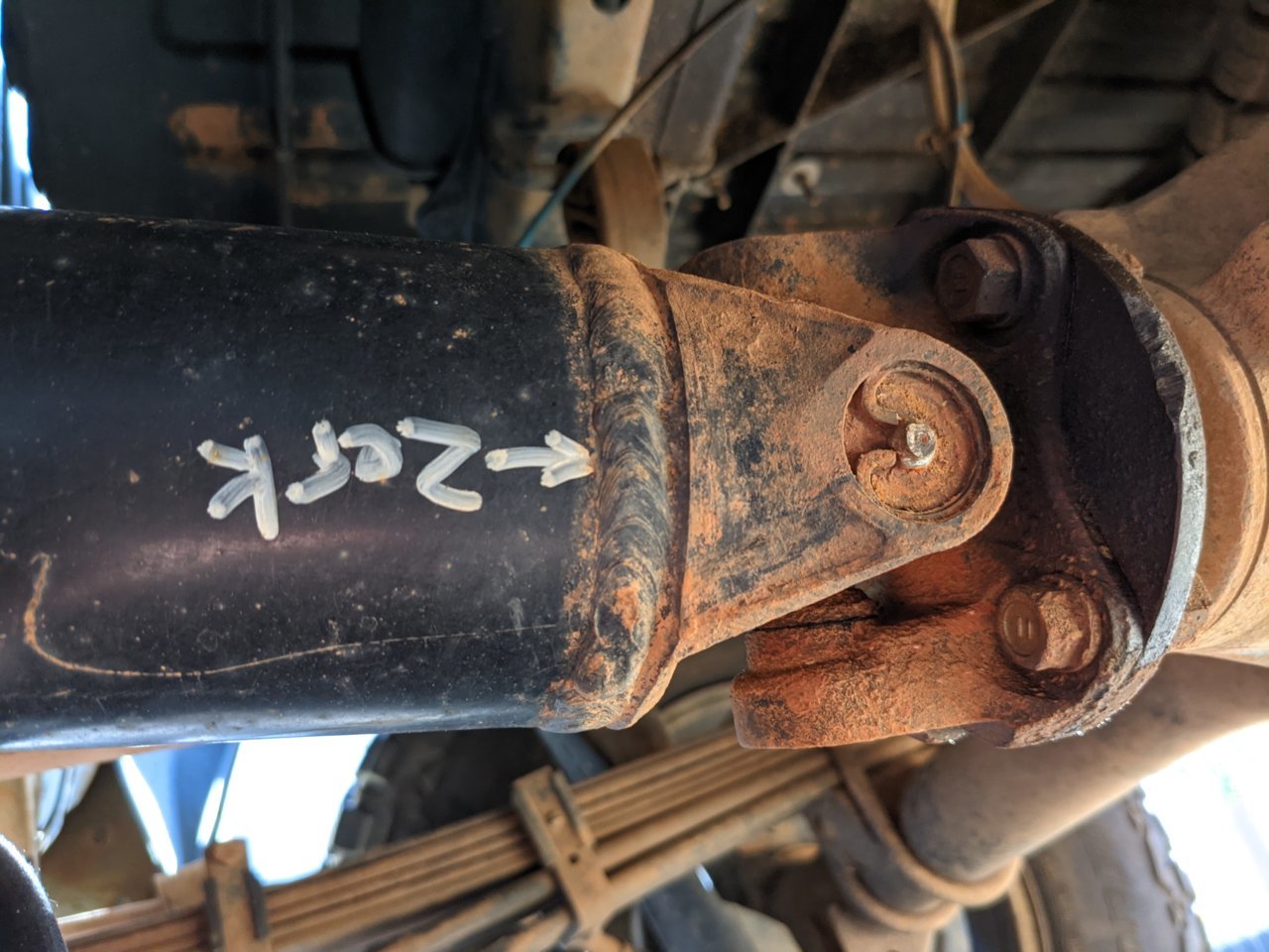

    I tried :rofl:

    The zerk needs replaced.. It's been ground down by rocks lol
