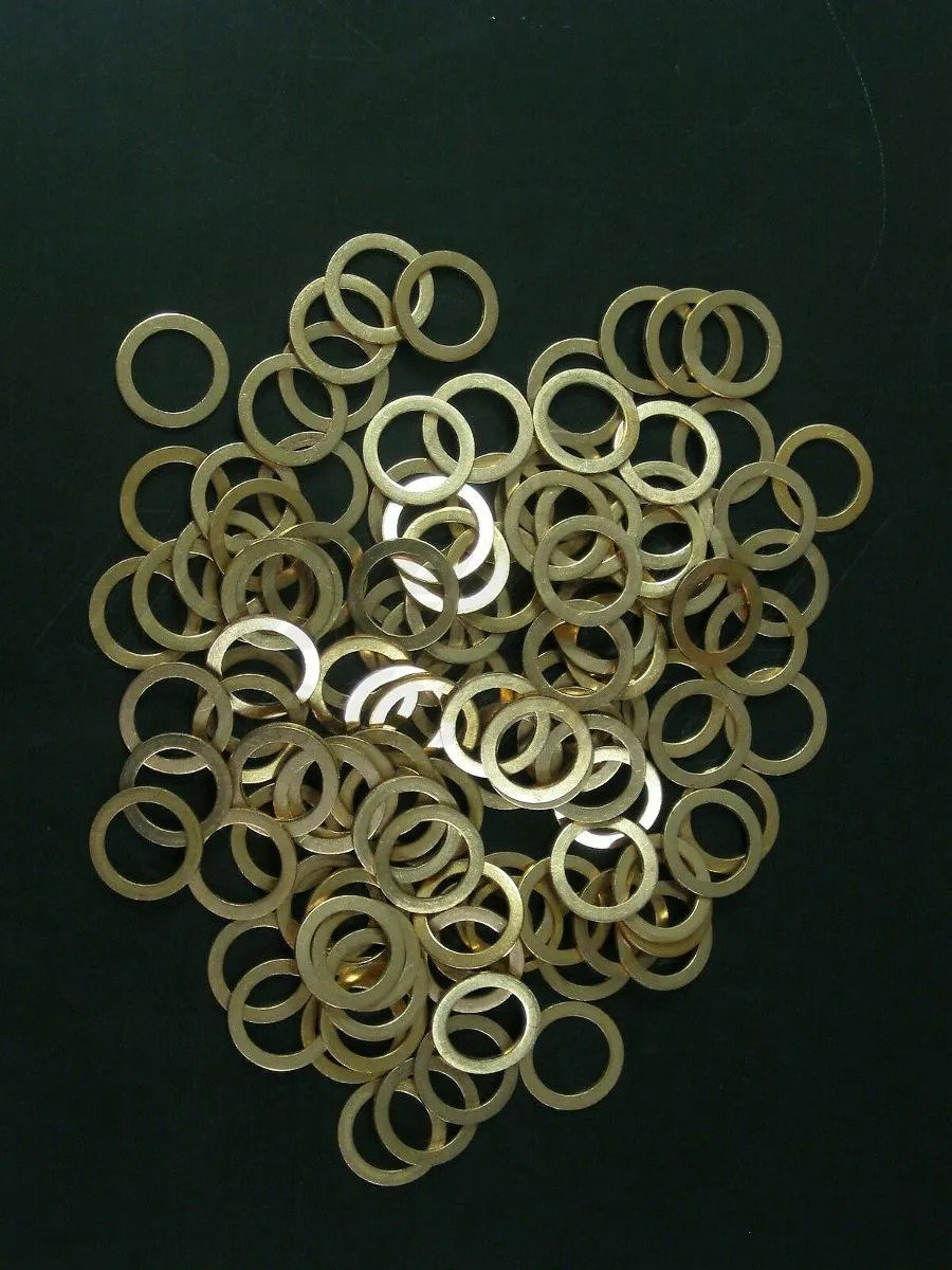

    my apologies if I missed it but does anyone know dimensions on acquiring a drain plug washer
    looking to put a stop to going to the dealer for the expensive felt coated one every time
    And just stock up on metal washers copper or aluminum sealing from a hardware store
    To have a pack of many stocked up no drive trip needed
    I have a Dimple magnetic oil pan plug and use Toyota OEM washers on it so I assume the dimensions aren’t anything crazy
    I think the dimple plug is m12x1.25x12
    which I think means to find a sealing washer the criteria would simply be that it has to be an M12. I’ll plan on getting that and see what happens
    don’t know if it matters copper vs aluminum. I’ve never had an issue with either on any vehicle torqued to spec so I imagine it doesn’t matter

    Why not just buy them in bulk, with your filters, this way? :confused:
    https://www.ebay.com/itm/354192771148

    dealer charges me like 5 bucks for a filter that’s confirmed genuine non counterfeit
    YZZD3
    can’t complain
    thanks I’ll look into it
    Hopefully they don’t have the potential to bash open leak on a rock
    I’ve gotten surprisingly better at taking off my big heavy skid plate after enough times but routing a hose would be convenient
    Doesn’t have an access hole though
    I’ll have to check if there’s even enough room. Truck has JD LCA pivots with their matching JD engine skid which also raises clearance making the skid higher
    access hole for fumoto might mean cutting a hole
    I’ll check if there’s a workaround like if my hand would fit sneaking from the side somewhere
    plus current plug is magnetic to catch debris and inspect engine health whereas Fumoto is not.
