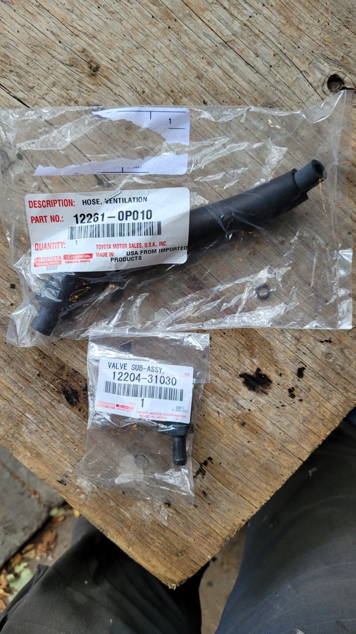

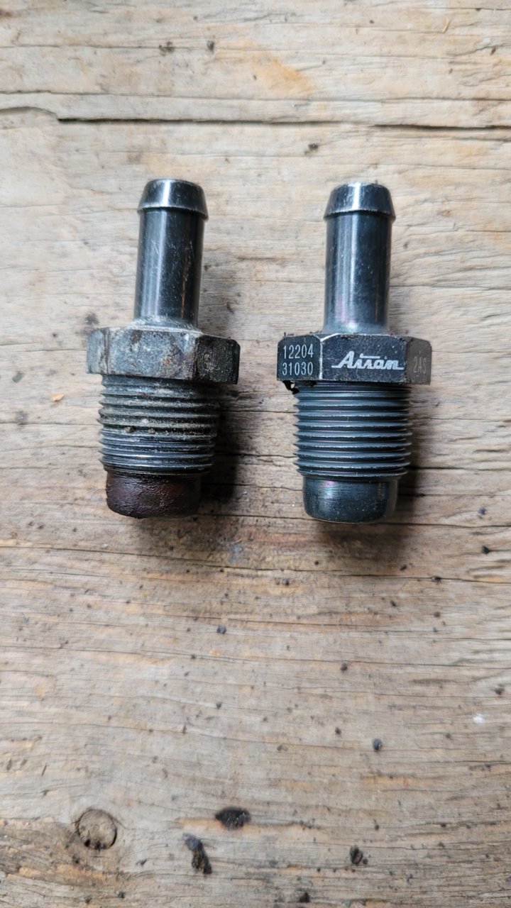

    Replaced the PCV today, for the 1st time. 225K Km, ON truck.... will do it more frequently going forward. I could hear the ball rattling around in the old one when I shook it, which is a good sign. Torqued new one to 20 ft. Lbs

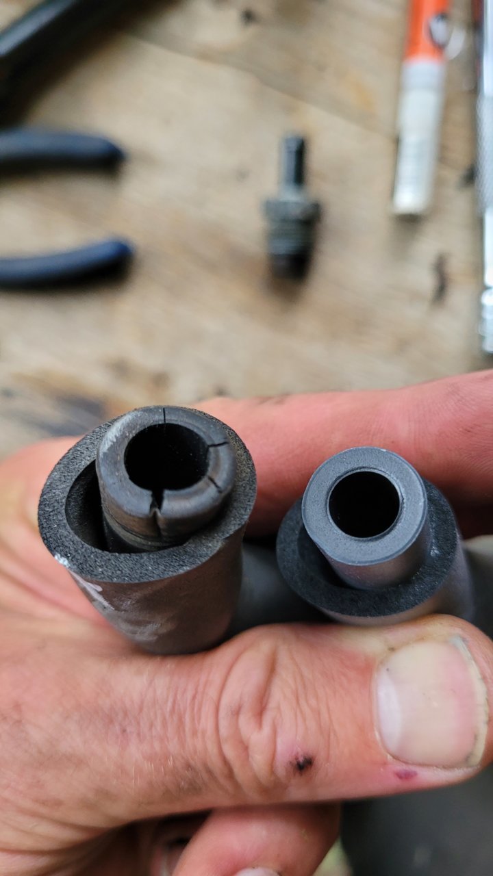

    I noticed some cracking on the hose, so replaced that too.

    I noticed my hose was cracked when I replaced my PCV valve, so I replaced it too.

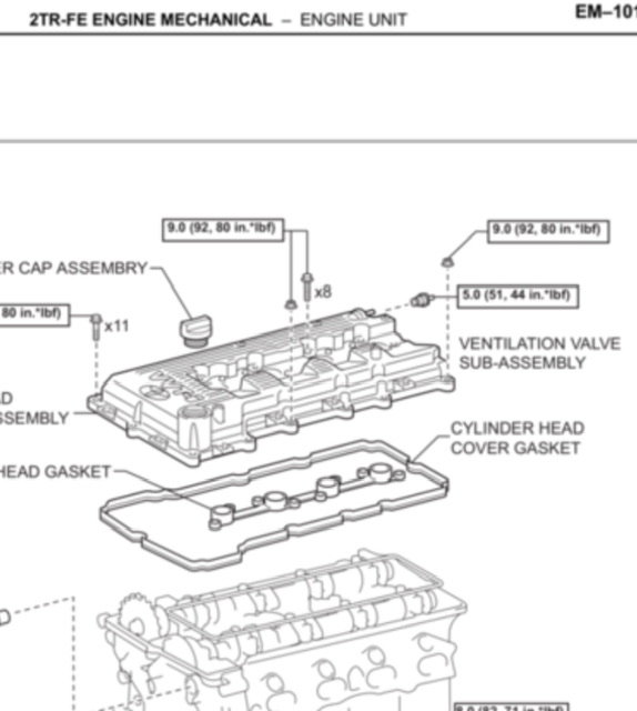

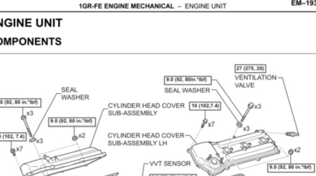

    20 ft/lbs per the book, for V6. 44 inch/lbs for 4 cyl.

    Sorry for the diversion guys, but I'm new to Toyota. Is there an online source for OEM parts that has diagrams like the one Chuy posted so you can find your parts and part numbers and then order?
