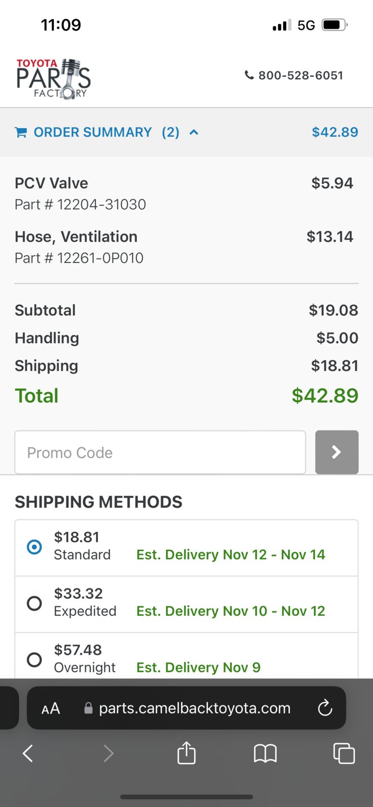

    I think I will be doing this over the weekend if my local dealership has the parts.
    :EDIT: Local Stealership wants $49.63 for both PCV Valve & Hose!
    Camelback Toyota has good prices but the shipping makes it expensive as well(still cheaper than my local dealership).
    Any idea where I could buy the OEM Parts and not pay so much for shipping?

    I just drove to the dealership...but it's 2 mile away from me. I paid full price $7.90 for the valve, cash, right at the counter
    For the hose I just cut a length off some my dad had in the garage. Think it came from autozone. It's a bit tighter fit too. I think it'll be better. I used some AT-205 to slip the hose on. All rubber loves that stuff and soaks it up.
    Toyota offers free shipping for purchases over $75. Good Luck!

    Strange. The dealers here in my area usually can get parts overnight from Jacksonville with zero shipping charges.
